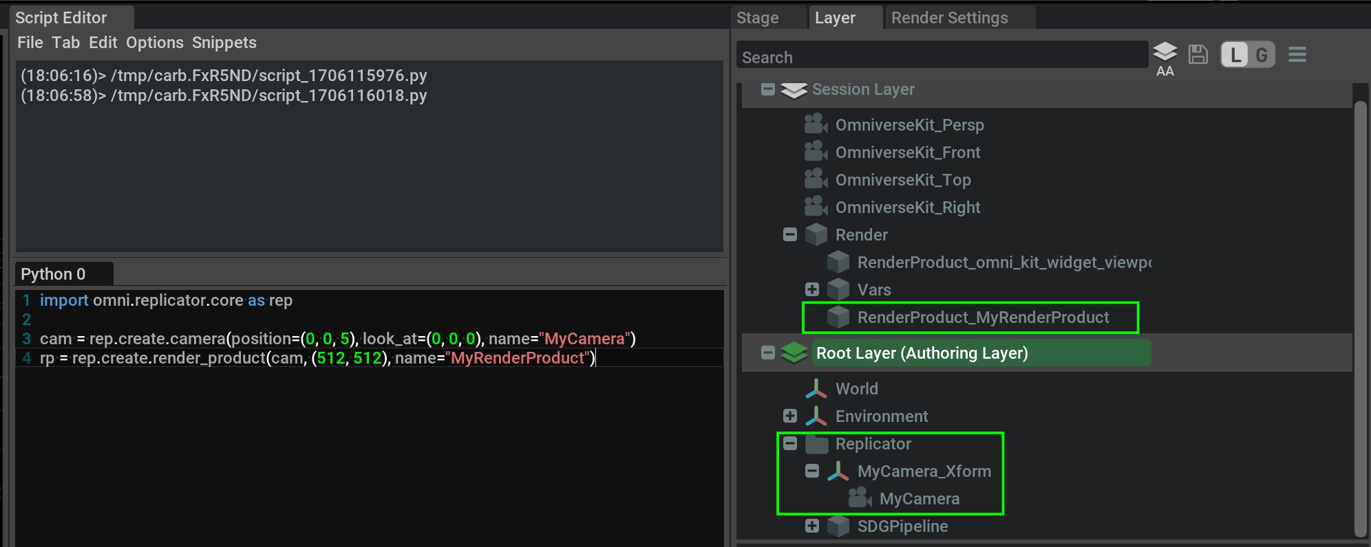

Hi there, does this script work for you:
cam = rep.create.camera(position=(0, 0, 5), look_at=(0, 0, 0), name="MyCamera")
rp = rep.create.render_product(cam, (512, 512), name="MyRenderProduct")

The lines of code work for me:
rgb = rep.AnnotatorRegistry.get_annotator("rgb")
rgb.attach([rp])
print(f"rgb annot name: {rgb.get_name()}")
Is it possible to provide a small repro script with the issue?
