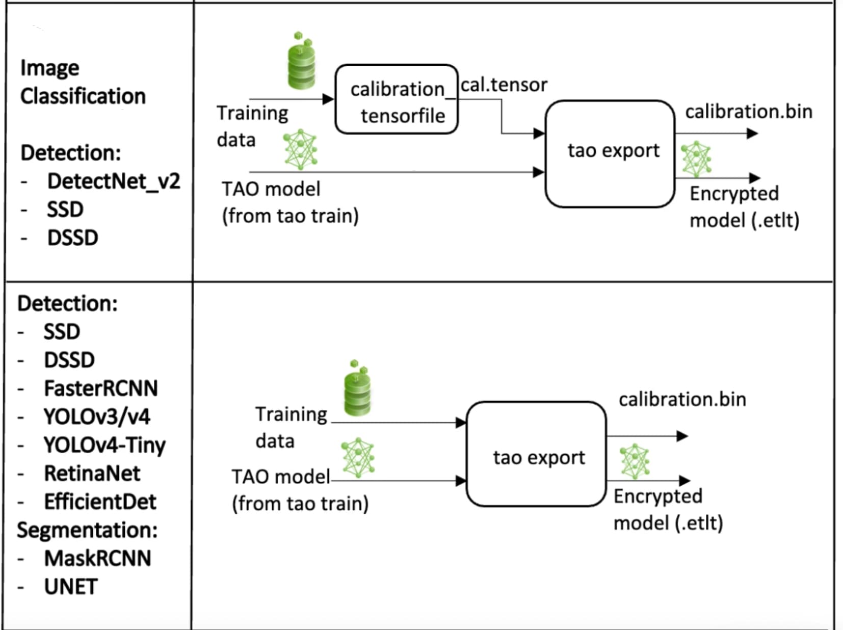

I’m having the same issue described in this thread: unable to understand how to produce the Yolov4 calibration cache (calibration.bin) required for engine generation in INT8 format. The TAO TK v4.0.1 documentation says the following:
If tao yolo_v4 export is run with the --data_type flag set to int8 , the calibration cache is generated using a calibration tensor file.
Q1: How can we generate this calibration tensor file for Yolo_v4 architecture?
From my understanding of below diagram from DetectNet_v2 doc, with DetectNet_v2 architecture we have access to the calibration_tensorfile function to generate this calibration tensor file. However, this is not an option with Yolo_v4 architecture. The diagram also indicates that for Yolo_v4, the calibration.bin should be generated directly with the export function using the .tlt model and the training images as input.
Thus, there is some contradiction between the Yolo_v4 doc and the DetecNet_v2 diagram. Please clarify whether we need to generate the calibration tensor file prior to the calibration.bin file to use it as input of the yolo_v4 export command.
Q2: If we do not need to generate a calibration tensor file prior to the calibration.bin export, how can we use the yolo_v4 export to generate the calibration binary?
I have the exact same issue as described in the topic referred at the top. If I omit the --cal_data_file in the export query, it gives me a missing file error ; as if the tensor file is needed as an input (see printout below). If I include the --cal_data_file parameter, as proposed in the previous topic, then the error message says it cannot find the /export/cal.tensorfile, which really gives us a hint that this argument is for input and not ouput.

Alright, it finally went through. Not too sure what was going wrong before.
TAO_COMMAND = ' yolo_v4 export -m $EXPERIMENT_DIR_DOCK/experiment_dir_retrain/weights/yolov4_mobilenet_v2_epoch_120.tlt  \
                                -o $EXPERIMENT_DIR_DOCK/export_cmd/yolov4_mobilenet_v2_epoch_120_int8.etlt \
                                -e $SPECS_DIR_DOCK/yolo_v4_retrain_mobilenet_v2_coco.txt \
                                -k $KEY \
                                --cal_image_dir  $DATA_DIR_DOCK/training/train \
                                --data_type int8 \
                                --batch_size 16 \
                                --batches 50 \
                                --cal_cache_file $EXPERIMENT_DIR_DOCK/export_cmd/cal.bin \
                                --cal_data_file $EXPERIMENT_DIR_DOCK/export_cmd/cal.tensorfile'
