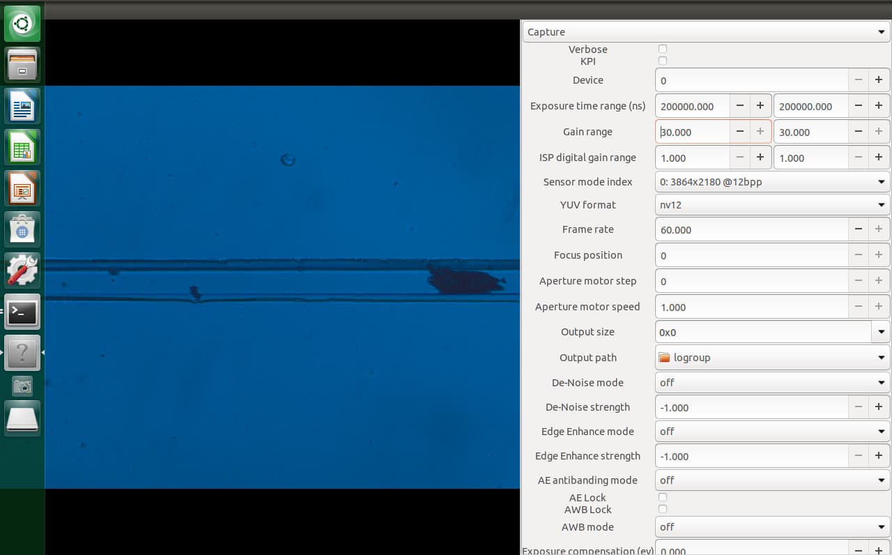

I’m using IMX334 camera on TX2 R32.3.1
And I found that the image didn’t change if when I changed the gain.
Do any one know what can I do to change the gain?

Can’t load the picture.
Did you modify the max/min to the same value to confirm.
The gain configure here is range configure.
Yes, I set max/min gain to the same number, but nothing change.
I thinks it might be the problem of driver.
You can print some information in the set_gain() function in the sensor driver to confirm it.
