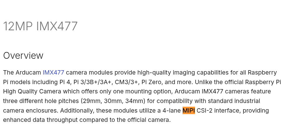

  1. From the dmesg logs we do see the camera being bound. For comparison check my IMX464 bound to my Jetson Orin NX:
imx464 9-001a: tegracam sensor driver:imx464_v2.0.6
tegra-camrtc-capture-vi tegra-capture-vi: subdev imx464 9-001a bound
imx464 9-001a: Detected imx464 sensor
In your case, there is no imx464 9-001a: Detected imx464 sensorThis may suggest wrong communication with the sensor.
  1. Can you please share the output for the following command just for confirmation:
i2cdetect -y -r 9
This will tell us if that address is being used by the kernel, regardless it does not mean camera is ready for use.
  1. Also I did a little research and found this regarding the ARDUCAM camera(Taken from here: 12MP IMX477 ARDUCAM):
Check that the device tree overlay you loaded has support for 4-lane. Feel free to share the device tree file.
Regarding your questions:
  • The error you are seeing for imx477 at 10-001ais expected since you only have one camera connected. It seems you loaded a DTBO that gives support for two cameras. This should not affect the behavior for camera at 9-001a.
  • lsmod output confirms driver modules is loaded.
  • modprobe loads the module in case it was not loaded.
Let me know if this helps!
Best regards,
Nico

Thanks for sharing the DTB. However, this DTB is the base DTB. Not the DTBO file for IMX477.
I suspect that you are using the overlay that supports IMX477 with 2-lanes. You should try using file: tegra234-p3767-camera-p3768-imx477-dual-4lane.dtbo located in /boot directory.
Can you try the following to test:
  1. Modify your /boot/extlinux/extlinux.conf to include your base DTB as well as the overlay you want to use. Add these lines to the file:
FDT /boot/dtb/kernel_tegra234-p3768-0000+p3767-0005-nv-super.dtb
OVERLAYS /boot/tegra234-p3767-camera-p3768-imx477-dual-4lane.dtbo
  1. Reboot the board and test connecting the camera to both cam0 and cam1 and check if it works.
Please let me know if this helps!
Best regards,
Nico
