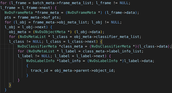

The code in deepstream-appsrc-test is always error.
“track_id = obj_meta->parent->object_id;”
I need to get sgie parent object_id.
I can’t use “track_id = obj_meta->object_id;”.
That always get “-1”,

I used the deepstream-app code, I can use the object_id of sgie parent.
However, I used the deepstream-appsrc code, I can’t use the object_id of sgie parent.
It always appears error.

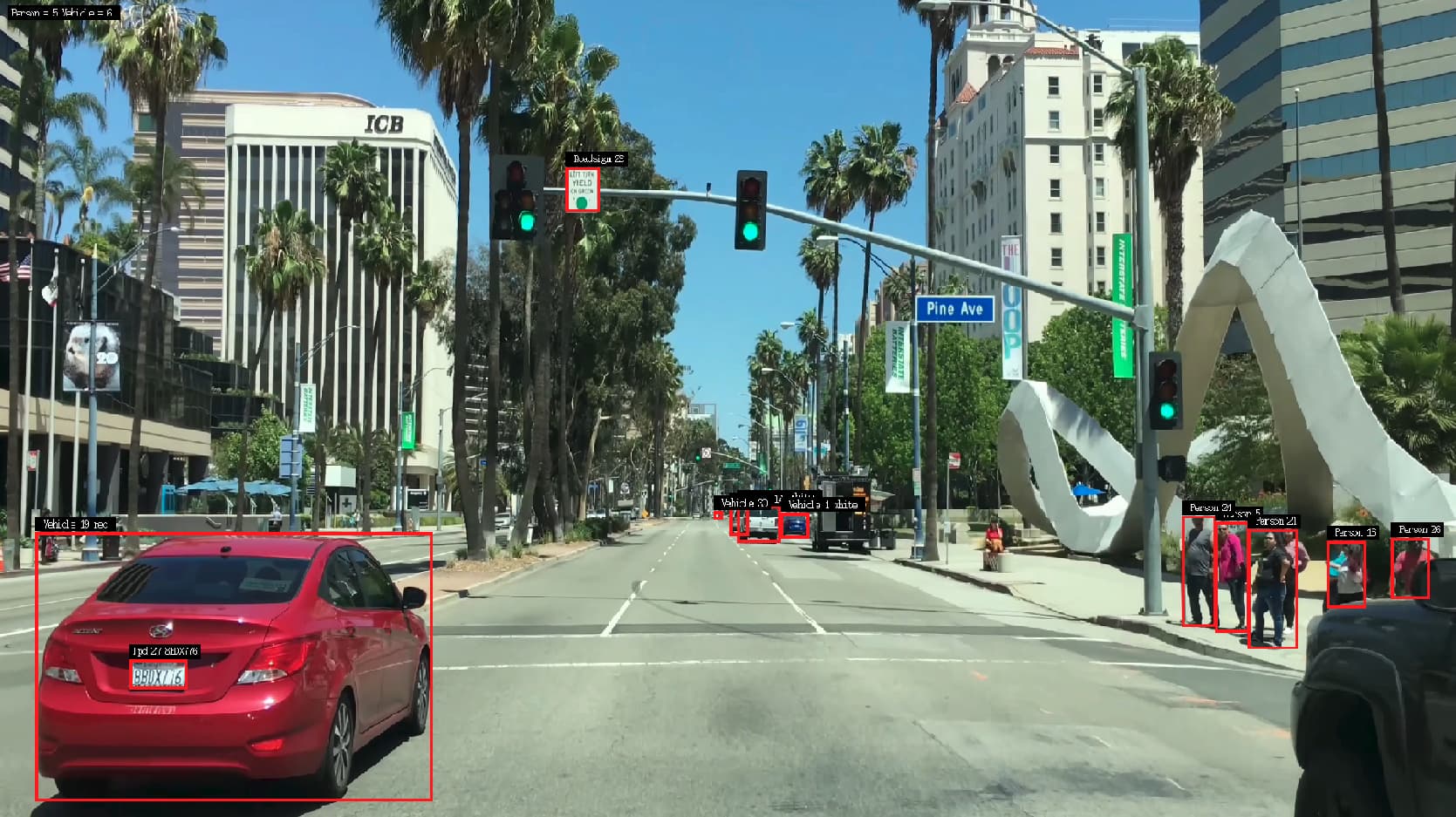

the default value of object_id is -1, object_id should not be -1 if enable tracker, did you see the object’s track-id on the video screen?
This is my screen. Screen is ok.
However, I wanna get object-parent-id from pgie.
It’s fail at deepstream-appsrc-test, but I can get it at deepstream-app.
Another words, original pipeline is “pgie=>tracker=>sgie”, I changed to “pgie=>sgie=>tracker”.

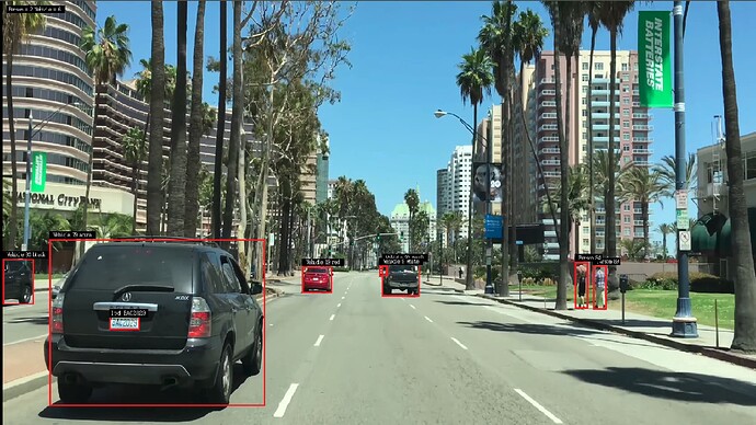

I mean
My first image is “pgie->tracker->sgie” pipeline.
My Second image is “pgie->sgie->tracker” pipeline.
All is fail, can’t get the object_id of sgie parent.

=> I check the method of the gstnvinfer_meta_utils.cpp file.
Therefore, parent object is null, I should how get it? I wanna get parent object from sgie.
Because sgie object_id is “-1”, that’s not useful.
pgie will add object meta, sgie will not add object meta if sgie is classification, sgie will add classification meta to object, so if tracker is behind sgie, object-id will be -1 because this value will be updated by tracker.

  1. this code is to add probe function sgie1_src_pad_buffer_probe on sgie’s src, you can also do this in deepstream_appsrc.c. osd is behind sgie, sgie and osd 's src alll are ok.
  2. if sgie is also a detection, it will add new object, the new object ‘s parent should be the object pgie added, then you can know the sgie-object is from which pgie-object. if sgie is classification, the objects are added by pgie, the objects’ s parent is NULL.
Thank you, it’s successfull.
