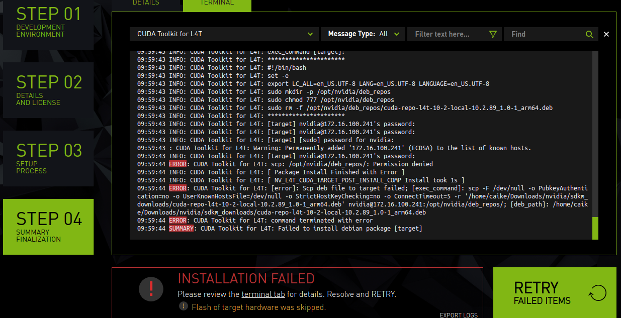

i use sdkmanager 1.4.1.7402 to flash tx2 with jetpack 4.4.1, the jetson os image installed OK!
but , however i try, i can’t install the sdk into tx2!
error liks this:
HELP ME! PLEASE!
error liks this:
Maybe you can read the image you posted first.
It says permission denied when sdkmanager attempts to scp the file to your tegra. Are you sure the password and account are correct?
i resolved! i modify /opt/nvidia/deb_repos directory authority on tx2 :
sudo chmod 777 /opt/nvidia/deb_repos
everything is ok!!!
