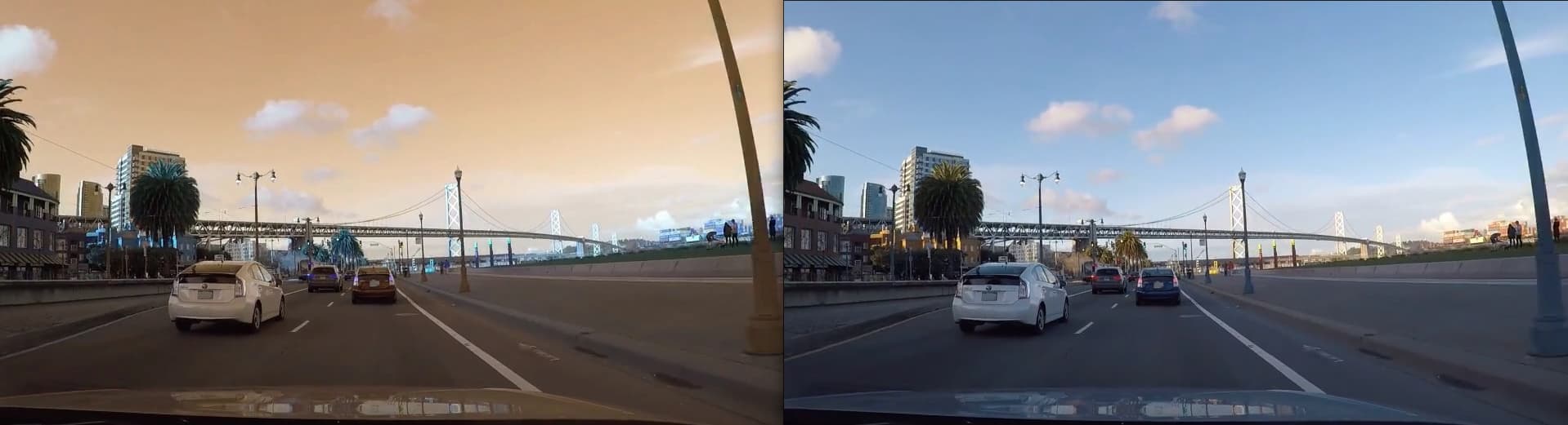

Hi, sorry for the missing details.
I’m on Ubuntu 22.04 on dGPU.
For now it’s only a plugin that switch red and blue channels on the video. It’s a simple one but it’s for experimentation.
I can run it with the gst-launch-1.0 command and on a Deepstream pipeline (python but that shouldn’t be the cause) :
(with and without the plugin)
