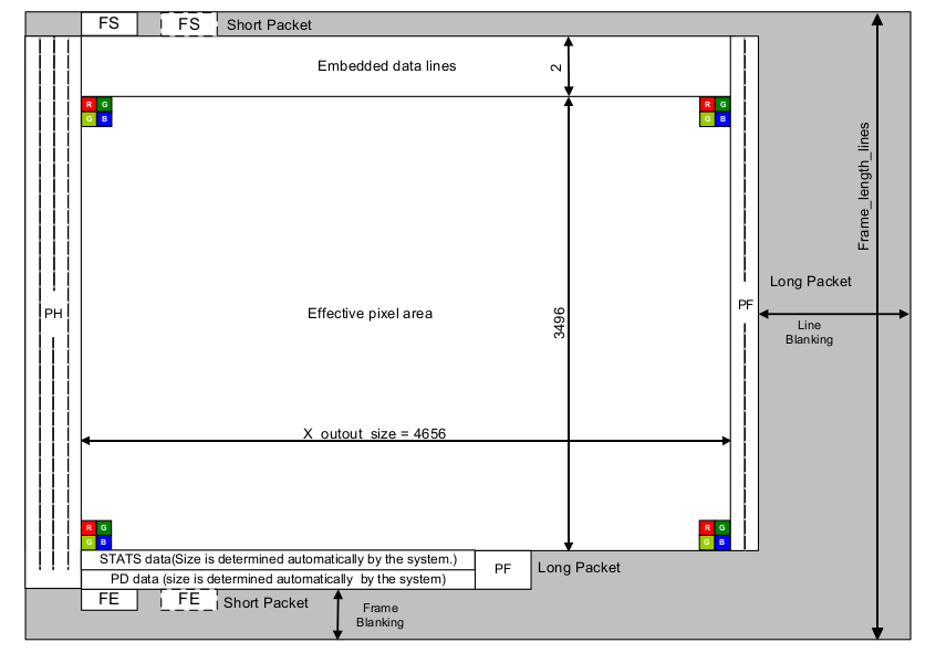

I’m trying to capture the PD data at the end of a sensor frame, the information should flow as follows:
Currently we are able to receive the embedded data lines at the beginning of the frame properly , but no so with the PD data and the STATS data. In order to receive the PD data we are trying to set the PD data and the STATS data as pixel data information, then increase the size of the expected buffer to “fool” the VI driver to read the PD data as pixel information. The idea to have both , STATS_data and PD_data on the frame marked as effective pixel line, Since the FE comes at the end of both frames the data should be able to pass as it as such. In order to change the the headers of the PD data and the Stats data we change the header using the following registers
And setting the header as as 6’h2B, afterwards the height for resolution of the frame is increased by two and we try to capture the frame. However when I try to do this I get the following error :

Does the PD data and the STATS data the same as frame line(4656)? This could be a problem.
Hi Shane,
According to the sensor documentation under our current settings they do. Any recommendations?
Thanks in advance.
I think it should be no problem. If the embedded can fake as pixel data correctly.
Please enable the trace and using v4l2-ctl to get raw data to debug.

The trace show CHANSEL_SHORT_FRAME looks like the high of resolution is incorrect.
BTW odd and even both can support for vi mode.
