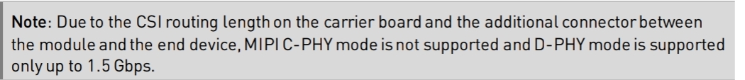

Carrier board D-phy speed
Is the D-phy speed 1.5 gbps for one lane? Or all lanes?
Each lane per 1.5Gbps
