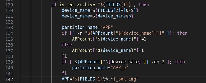

I tried l4t_backup_restore and massflash on jetson orin nano devkit with BSP r36.4.3. The rootfs is the nvidia’s minimal_sample_fs.
I finished the test by following steps:
under root dir of L4T

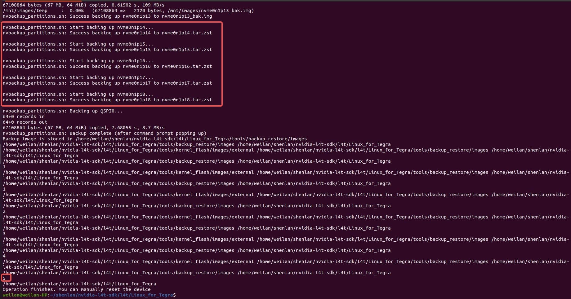

step1 backup
$ sudo ./tools/backup_restore/l4t_backup_restore.sh -b -c jetson-orin-nano-devkit-super
step 2 make mfi

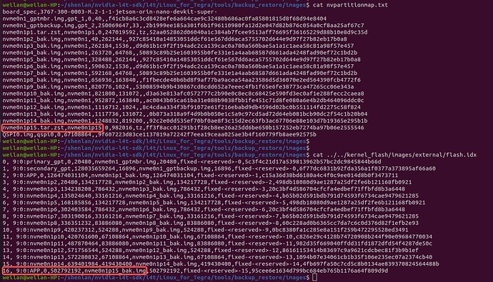

$ sudo ./tools/kernel_flash/l4t_initrd_flash.sh --use-backup-image --no-flash --network usb0 --massflash 5 jetson-orin-nano-devkit-super internal
step 3 untar mfi tarball
change to another dir (out of L4T), then copy mfi_jetson-orin-nano-devkit-super.tar.gz, then
$ sudo tar xpvf mfi_jetson-orin-nano-devkit-super.tar.gz
step 4 flash with massflash option
cd mfi_jetson-orin-nano-devkit-super first, then
$ sudo ./tools/kernel_flash/l4t_initrd_flash.sh --flash-only --massflash 5 --network usb0
All the processes above were succeeded. But the system can not boot successfully.
Meanwhile, I can use the l4t_backup_restore.sh -r to restore, reboot and run system very weill.

PS: my storage is nvme ssd but not sdcard.
Please try below commands:
#Backup:
sudo ./tools/backup_restore/l4t_backup_restore.sh -e nvme0n1 -b -c  jetson-orin-nano-devkit-super
#Massflash (generate a massflash package):
#Massflash
sudo ./tools/kernel_flash/l4t_initrd_flash.sh --flash-only --network usb0 --massflash 1
You dont need to dostep3 untar mfi tarball.

I’ve found something error.
In my sdk, p15 partition lable name is ‘reserved’ as flash_l4t_t234_nvme.xml defined, but I made format into ext4 at flash script.
In l4t_backup_restore.func, convert_backup_image_to_initrd_flash() function will treat all ext4 partitions as APP, which I think is a bug.
So each time I use ‘l4t_initrd_flash.sh --flash-only --network usb0 --massflash 1’, it will overrite APP by the latest fake APP img.
@DavidDDD Do you have any suggestions if I want to fix this bug becuase I’m planning more ext4 partitions than APP only.
Could you point out which line the function treat all ext4 as APP?

In file l4t_backup_restore.func, please note this:
Could you add debug line below and run again, also report the results for us?

Could you provide your nvpartitionmap.txt and flash.idx info again?
Sorry, I’ve fixed by myself, the old debug env is overrittend.
But you could re-produce this issue easily. The only prerequisite you shoud do is to create at least one more ext4 partition than APP.
