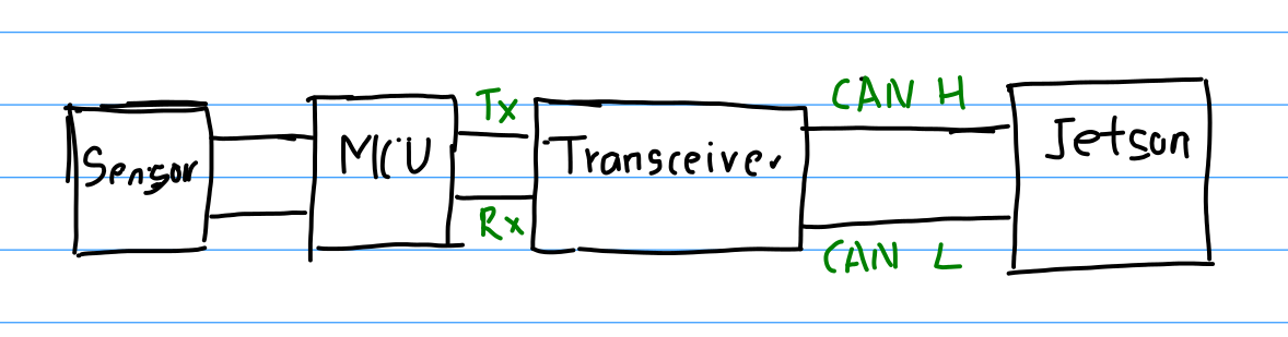

I am dealing with a differential drive robot that interacts with several motors and actuators, all through the Jetson Xavier. I use Python3 for programming all actions of the robot that go through a microcontroller via CAN bus.
Now, there are multiple parts of the robot that we need to program; chiefly navigation and arm-movement. Right now, the robot does only either of them, i.e., it can either move or perform some arm-movement. All the actions are based on the same 1D LiDAR sensor.

The main process or the parent process detects when its show time and spawns two child processes: p_navigation and p_arm. Both these process start together and have their own instance of dump_lidar working in their respective processors. Both terminate on the basis of the same condition. In the meantime, the parent process does nothing.
I notice that there is a considerable delay (upto 1s) between the data procured by the dump_lidar in the parent process as compared to the ones in the child processes. It is also possible that the CAN bus is giving the data after a certain delay.
