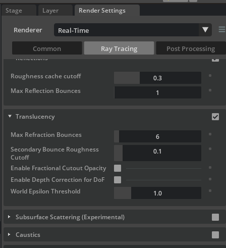

@pekka.varis there is a
Enable Opacity Cutout
option on RL realtime export PBR mdl,
default is ON, because RTX Realtime mode didn’t support semi transparency in previous version of Create.
Maybe you could try disable opacity cutout and see if the current RTX RealTime renderer has
support now, you also need to check the preference is enabled
Ok, thank you!
This helped to eliminate the scalp problem, that visible seam.
Hair itself was slow & noisy when opacity cutout was OFF.
But I can live with this, for RTX realtime it looks pretty good!
