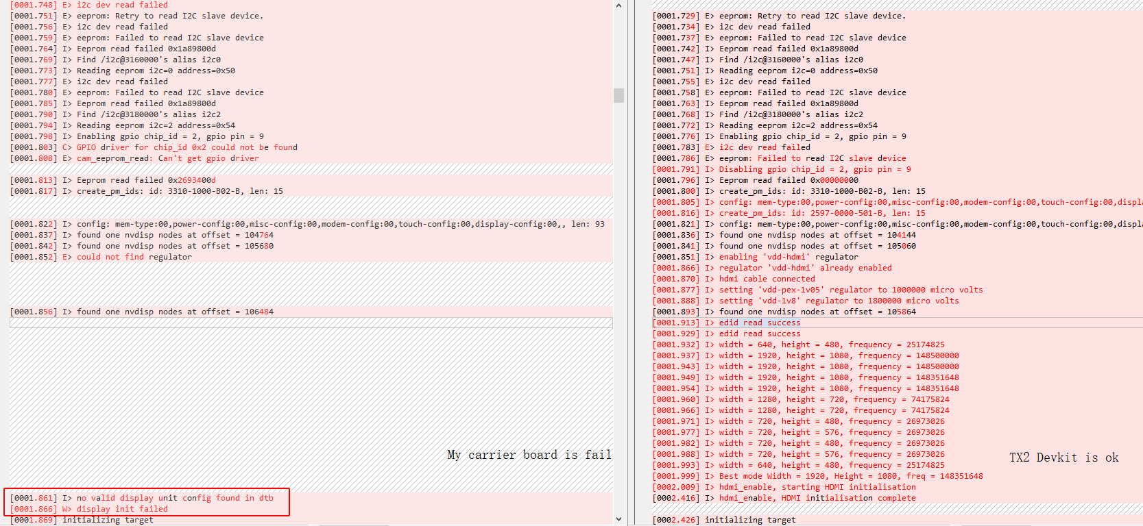

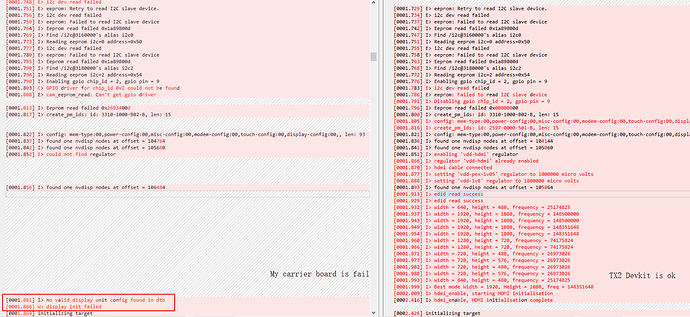

Change cboot boot logo with customer design carrier board
I can change cboot boot logo on TX2 devkit with following ticket method. But my carrier board can’t show anything when in cboot start process. I can see HDMI initialization is failed from start log, but when it start in kernel, HDMI display is ok. How to enable HDMI in cboot with my carrier board to show cboot logo?
https://devtalk.nvidia.com/default/topic/1031327/jetson-tx2/change-cboot-boot-logo-l4t-28-2-/

[0001.496] E> i2c dev write failed
[0001.500] E> tca9539_device_init: failed to write polar reg
[0001.505] E> tegrabl_tca9539_init: failed to init device!
[0001.510] E> GPIO TCA9539 driver init failed

[0001.847] I> found one nvdisp nodes at offset = 104764
[0001.852] I> found one nvdisp nodes at offset = 105680
[0001.863] E> could not find regulator
[0001.866] I> found one nvdisp nodes at offset = 106484
[0001.871] I> no valid display unit config found in dtb
[0001.876] W> display init failed

[0002.758] E> tegrabl_linuxboot_add_disp_param, du 0 failed to get display params
[0002.765] E> tegrabl_linuxboot_add_disp_param, du 0 failed to get display params

[0003.041] E> tegrabl_display_clear: display is not initialized
[0003.046] W> Boot logo display failed...
guohoujin2006,
We just released the source code of cboot. Could you try to add some debug log in it and see what happened?
The file is “tegrabl_display_dtb.c” and you could check why there is no valid display unit in “tegrabl_display_get_du_list”

If I use the right cboot source code? If I use the right method to build the cboot source code? thanks!
I resolve the compiling error. I find in cboot, HDMI not display may caused by “vdd-hdmi” not enabled. I want to know how to configure bootloader dtb and compile it, thanks!
Is there a git repo tag available for this? I’m thinking of source_sync.sh instead of:
https://developer.nvidia.com/embedded/linux-tegra
WRT the compiler errors, we only spec the 4.8.5 gcc & tools that we provide in devtools for CBoot source build right now (see CBoot_Standalone_Readme.txt in the source archive), as that’s the same toolset we use internally. Using a newer gcc will generate warnings/errors as it encounters code that needs to be ‘fixed’. So although you’ve already fixed these problems, it would be best to use the 4.8.5 tools in the future so we’re comparing apples w/apples.
As to rebuilding the DTB, it should be as simple as using the device tree compiler, I would think (DTC) - I don’t do that on a regular basis, so I’ll defer to someone w/more experience, but I’d think that DTS modifications should be de rigueur for a board developer. On TX2, I believe (currently) the kernel DTB and the bootloader DTB are the same file (tegra186-quill-p3310-1000-a00-00-base.dtb)
  1. The cboot source code I downloaded doesn’t have git repo tag, I will download Jetpack 3.2.1 and use source_sync.sh instead of https://developer.nvidia.com/embedded/linux-tegra.
  2. Please check the attached picture, it show my carrier board cboot log compared with TX2 devkit. If kernel DTB and the bootloader DTB are the same file, why it start goto kernel, HDMI display is ok. Does this problem cause by my carrier board not design a EEPROM module(24C02, I2C address is 0x57). While in cboot, it will read content from the EEPROM.
  3. Is there some document about cboot software architecture, and how to flash cboot without flash filesystem to quicken flash speed?
I have fixed this problem, I modify vdd-hdmi regulator gpio in tegrabl_fixed_regulator.c, then this problem is resolved.
BTW, I can’t use source_sync.sh to download cboot source code.
/* FIXME - To obtain GPIO chip_id based on regulator name */
 	if (strncmp((const char *)temp_name, "vdd-hdmi", sizeof("vdd-hdmi")) == 0) {
-		entry->gpio_phandle = (TEGRA_GPIO_TCA9539_CHIPID_BASE  + 1);
