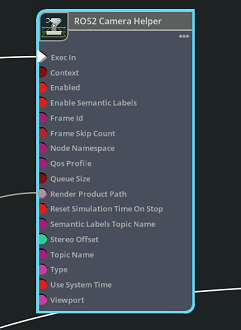

I used ros2_camera_helper to get bbox3d data, but the class_id only includes 13 classes. I annotated 23 characters (e.g., character_0, character_1, etc.) using the annotation tool, yet it still only recognizes 13 classes.

Could you help clarify what “ros2_camera_helper” refers to? Also, could you provide detailed steps to reproduce this issue?
graph coding, ros2_camera_helper node, which can publish topic like img or bbox3d in img, and I connect it with a camera, using it to publish bbox3d messages, I annotate 23 human agent objects with 23 types, like character_0, character_1, But, It comes out only 13 class_id from

will have class_id = 6 for not only one
Could you share detailed reproduction steps for this issue to aid our investigation?
yes, there are reproduction steps below
① annotate like this
each person have a unique semantic type
② use omnigraph graph’s ros2 camera helper to publish bbox3d
③ eventually, we gathered bbox3d message, but not each person have unique class_id, some person have the same class_id when annotated different semantic type.
