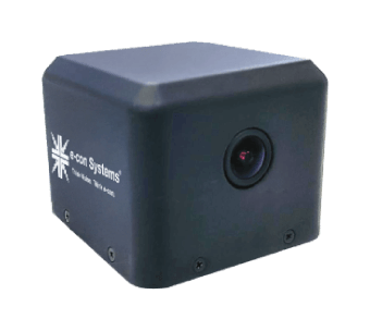

e-con Systems’ Holoscan camera solutions feature ACC_FPGA_MI_WTB_ADP, a compact 10G Ethernet adaptor board designed to interface with cameras using the MIPI CSI-2 interface for high-performance embedded vision applications. The compact HSB camera solution with enclosure is shown in the image below.
Figure 1: Compact HSB Camera Solution with Enclosure

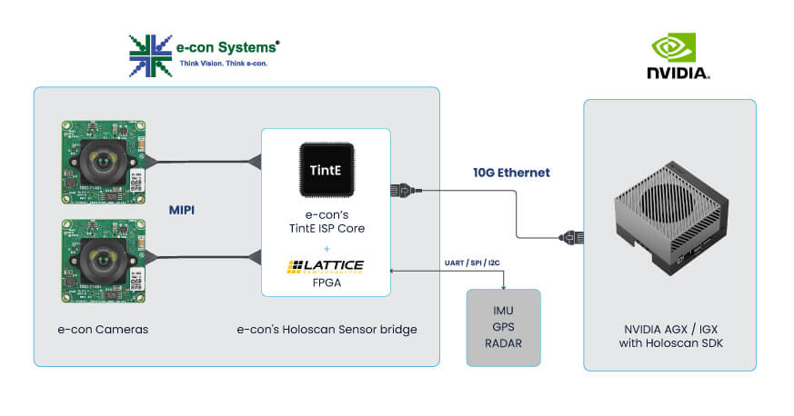

See the image below to understand how our HSB camera solutions work.
Figure 4: HSB Camera Solutions – conceptual diagram
Designed for seamless compatibility with NVIDIA AGX Orin™ and NVIDIA IGX Orin™ platforms, the adaptor supports integration via the NVIDIA Holoscan SDK, enabling advanced sensor processing and edge AI capabilities. The board also includes a USB Type-C power input for simplified deployment, and an IO Interface connector to support the Sensor Fusion with LiDAR and RADAR.
