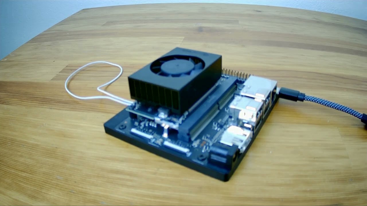

  • I have two Jetson Nano Super Dev Kits. TESTING…1…2…3
  • Installed both versions available.
    JetPack 5.1.3 SD - Works well and is running with my C++ Code (No Jetpack)
    JetPack 6.2. SD - Works well and is running with my C++ Code (No Jetpack)
  • C++ Code is working well, no issues. (g++ Legacy)

I’m somewhat confused as to what the situation is. I’m going to provide some information about how all of this fits together, which might point us in another direction (or not).
First, the Orin Nano comes in two broad categories: Dev kits, which have an SD card mounted on the module itself without any eMMC, and commercial module which is used on any carrier board such that the module has eMMC, but no SD card slot (the slot, if any, is on the carrier board for commercial versions). I’m assuming it is a dev kit, that seems to already be established.
The dev kit has QSPI memory on the module itself, and when you flash an SD card model of Jetson, it is the QSPI you are flashing. QSPI is updated in recovery mode using JetPack/SDK Manager which runs on a separate Ubuntu PC (depending on releases you would need either Ubuntu 20.04 or Ubuntu 22.04; Ubuntu 24.04 would fail). That QSPI is what runs all of the boot stages prior to the SD card loading (the SD card is the actual operating system; you can’t get to the SD card if the QSPI is not correct).
If you have an SD card, and you can mount it on a Linux machine (it doesn’t have to be the Jetson), then you can go to the mount point to see the SD card content. From there you can cd in to <mount point/etc/ and examine the output of “head -n 1 nv_tegra_release”. This tells you the L4T release.
L4T is what actually gets flashed, and is what you would call Ubuntu once NVIDIA content is applied. This includes what gets flashed to the QSPI of the module. If the major release of L4T is R35.x, then it is expected that you have already flashed the QSPI with R35.x. If the major release of L4T is R36.x, then it is expected that you have already flashed the QSPI with R36.x. Reaching the SD card depends on this QSPI. If you mismatch QSPI boot content major release with a different major release of the SD card, then boot will fail.
If you have an SD card prebuilt image, e.g., from one of the labs, then this should work if and only if its QSPI content is already flashed to a compatible major version.
If you boot to an NVMe or SSD, then there are more flash steps required, and those steps change what is in the QSPI (otherwise boot won’t reach the correct device).
If the major release in QSPI matches any prebuilt image, then a correct application of that image to the SD card should “just work” (assumes you are not using an external device like NVMe). It is easy to download a binary image and apply it to the SD card so long as the SD card is large enough.
