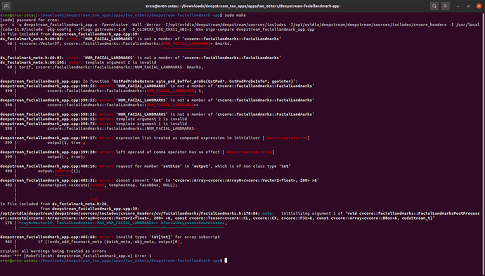

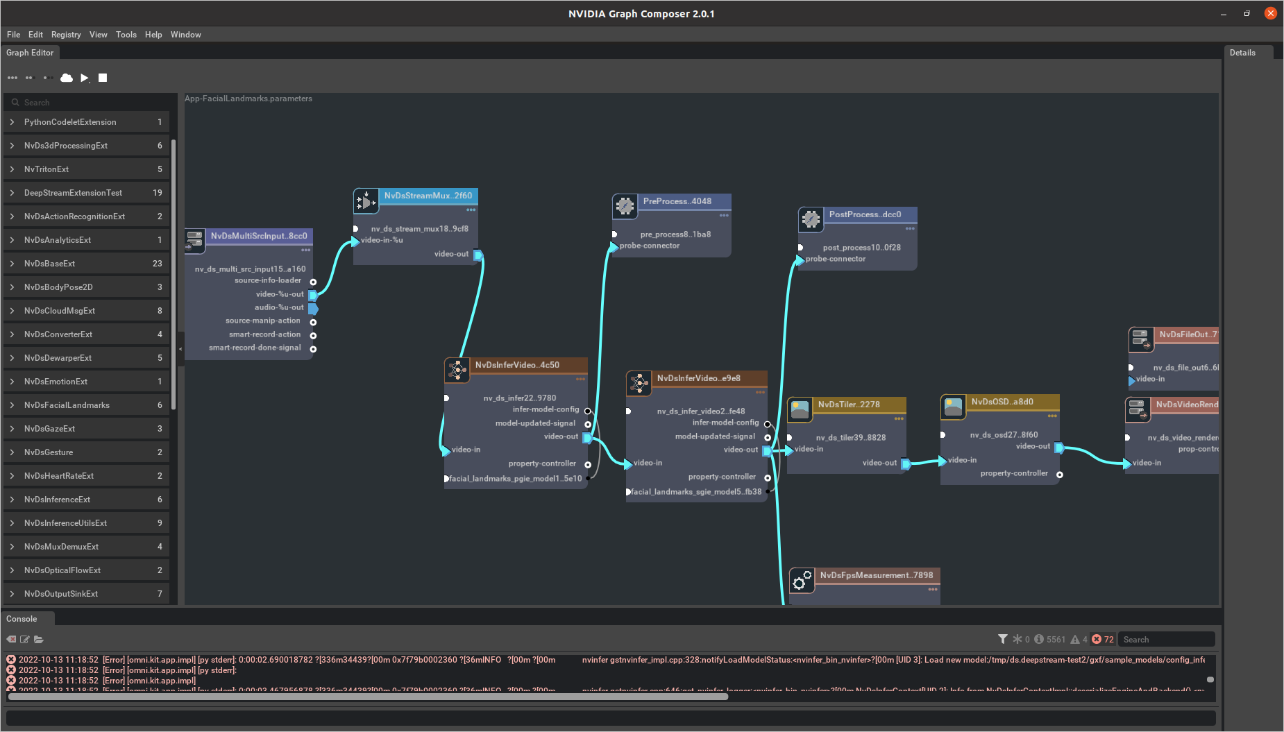

Now, I want to run the tao-app facial landmark example on graph composer. I can load and see the facial landmark graph. I do load the parameters too…But graph composer does not run and gives GXF_EXTENSION_FILE_NOT_FOUND Error…
Is it because I could not compile tao-apps?

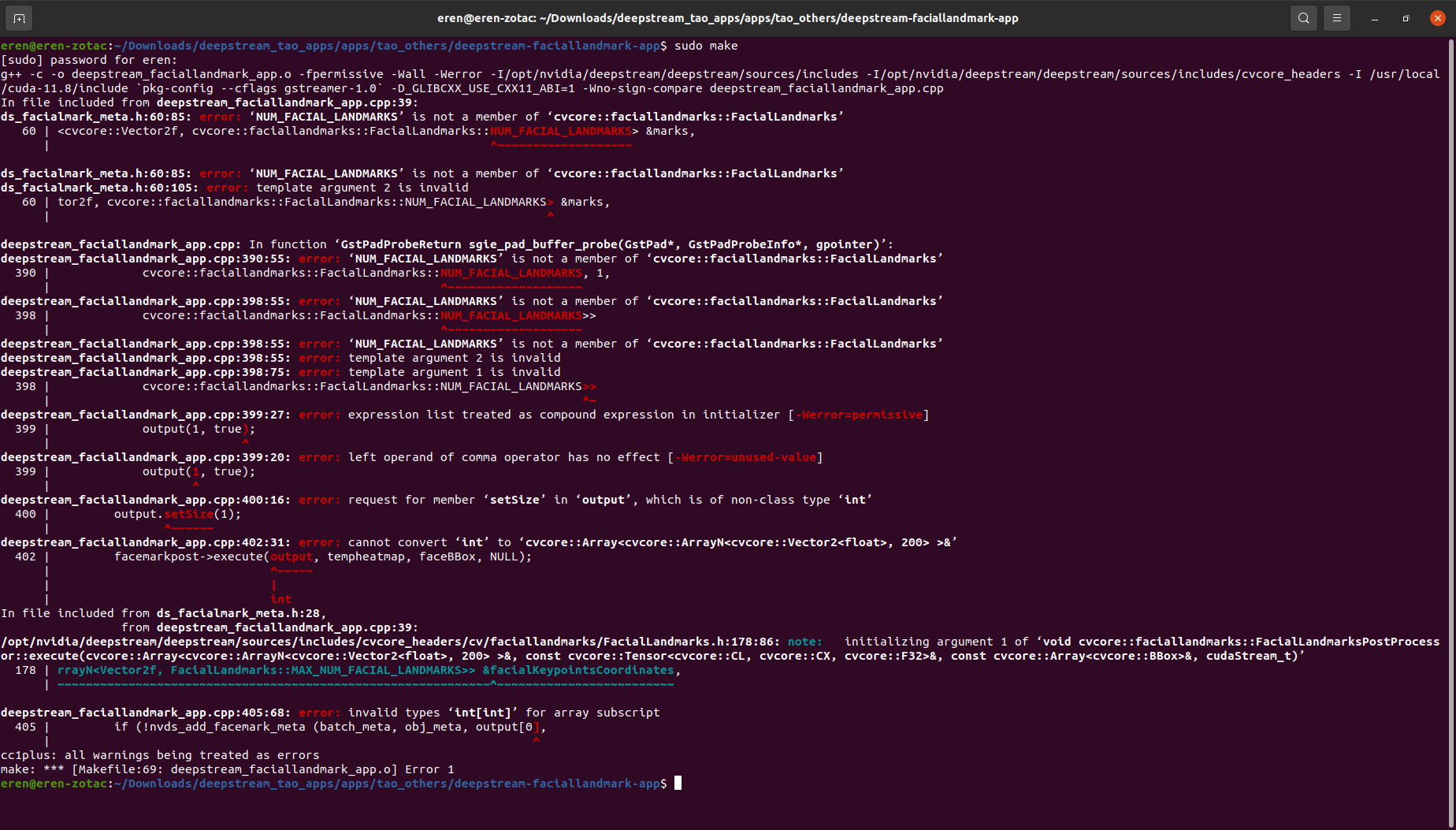

I change the cuda_version=11.8 in the make file
or
export CUDA_VER=11.8 …(tried also aother versions)
but cannot “sudo make” tao-apps or any subfolder app…

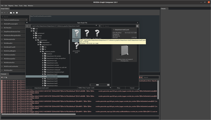

Graph Composer is based on DeepStream. Please install DeepStream 6.1.1 correctly. Current latest DeepStream 6.1.1 is based on CUDA11.7. Quickstart Guide — DeepStream 6.3 Release documentation

When I run facelandmark at tao apps, I can load but it does not work( I do load parameters too)

I can also not compile Tao Facial Landmark app, When I compile with cuda=11.8…
Do I have to downgrade to Cuda 11.7 for Tao-app graphs to work??

Graph Composer is based on DeepStream. Please install DeepStream 6.1.1 correctly. Current latest DeepStream 6.1.1 is based on CUDA11.7. Quickstart Guide — DeepStream 6.1.1 Release documentation
It worked with 11.7… The main mistake was actuall : I did not load the target in the reference graph folder correctly …
