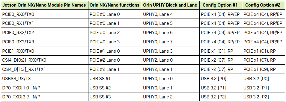

I’m currently configuring the Orin NX UPHY Lane. The documentation shows this table:
However it’s not completely clear to me the two configurations. The first option is to use CSI4_D[0:2]_RX0_TX0 and CSI4_D[1:3]_RX1_TX1 as one (PCIE x2)?
And the second option is to use CSI4_D[0:2]_RX0_TX0 and CSI4_D[1:3]_RX1_TX1separately as two PCIE x1?
please refer to the design guide document. It shall be more clear.
