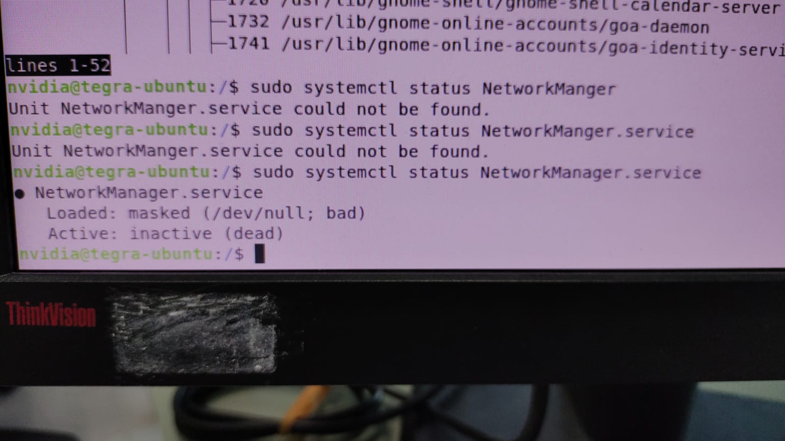

I try to connect to the net after flash the AGX Xavier with Software 10.0. i flow the instructions from:
but after running :
(1)sudo NetworkManager start
(2)IP: sudo ifconfig eth0 xx.xx.xx.xx netmask 255.255.255.0
(3)ROUTE:sudo route add default gw yy.yy.yy.yy # the yy.yy.yy.yy is the IP of the host
I still do not have connection.
Attach images with cable connection and ifconfig.
for sudo systemctl status NetworkManager.servise i get loaded: mase and Active inactive
I run NVIDIA DRIVE™ Software 10.0 and fallow instructions from Basic Configurations for the Drive AGX Xavier with Software 10.0.
Thanks for support!!
Hi @almog.hagag,
Networks are configured through systemd-networkd.
Have you tried without modifying anything after flashing?
Please check MCU firmware version with Using the MCU Console document.
Please explain how should I use systemd-networkd?
Have you tried without modifying anything after flashing? Yes,no connection.
Sorry, I don’t have connection to the target. I have display on the target with consule?
Do you have access to the host system (connecting to the target system)?
I don’t have access to the target from the host
I do have access to host.
Please help to follow Identifying the AURIX Step Version to get your firmware version.
Do i need to update the firmware ?

OK update, using ping to my host I see connection between the target and Host.
However when using ping to google (ping www.google.com) the AGX print:
PING ww.google.com (142.250.184.196) 65(84) bytes of date
But no replay/response from the remote.
The target block to internet open to local network.
I can ping it on my target system.
Maybe you need to check if check connection of the Ethernet cable with your laptop.
nvidia@tegra-ubuntu:~$ ping 142.250.184.196
PING 142.250.184.196 (142.250.184.196) 56(84) bytes of data.
64 bytes from 142.250.184.196: icmp_seq=1 ttl=108 time=101 ms
After reset i mange to connect, thanks
Good to hear it works on your side.
