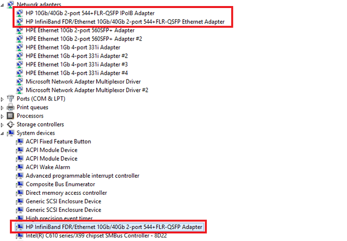

So, here is the thing - I need to connect two servers using ConnectX-3 Pro HCA’s without IB switch to run MPI applications with RDMA in Windows Server 2012 R2. To get the IB network running, I follow normal procedures: install the driver and WinOF, create the OpenSM service. Actually, everything works properly, and MPI tests show expected latency (~2 usec) and bandwidth (~4500 MB/s). But the problems arise when the servers are rebooted - ports #1 on both HCA’s always negotiate to use Ethernet protocol when the cable is plugged during system boot, regardless of the UEFI setting (per port, which strictly corresponds to mlxconfig setting). For example, when port 1 cable is plugged and port 2 is unplugged, the configuration becomes: Port 1 - Eth, Port 2 - IB. This is how it looks from the device manager:
And I’m unable to change that, because the driver settings are grayed out:
The availability of port protocol settings for both ports depends on UEFI(=mlxconfig) setting. For the first port it also depends on cable presence. When the cable is plugged during system boot, Port 1 is always grayed out with “Eth” chosen, regardless of the UEFI(=mlxconfig) setting. Rebooting the bus driver (disable/enable IB Adapter system device in Device Manager) doesn’t help. When the cable is unplugged and port protocol is set to VPI, the setting is available. The setting also becomes available right after the cable is unplugged from a running system. And the IB network works normally on the first port until next reboot. Seems like the Windows driver ignores 1st port setting from firmware. I would greatly appreciate any ideas why that may happen. Currently the workaround is to unplug the cable from both ports #1. I suspected, that one of the cables was faulty, but switching the cables had no effect, so I guess the cable is OK.
