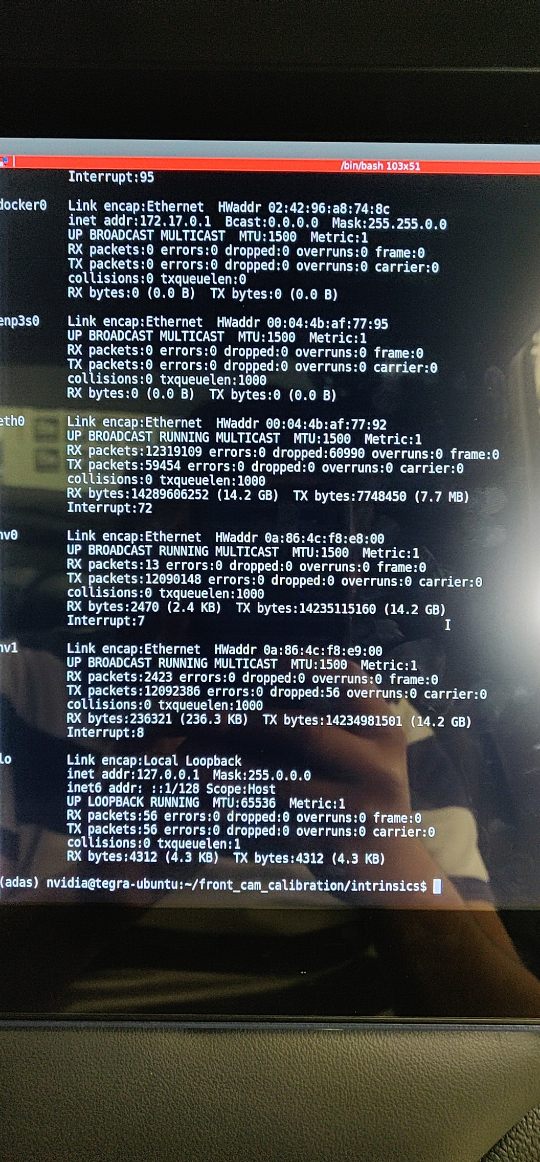

Attached please see the pictures of the behavior. please let us know what may have caused it and how to fix?

Could you please provide the ifconfig output? Thanks.
attached. thanks

According to the capture files, this is from the DriveAGX without any lidar/radar? 14.2G is huge receiving data.
Could you please help to re-check after reboot or flash DriveAGX if possible? Thanks.
Confirmed the cause from LiDAR. However, cpu usage was immediately changed to ~12% as soon as LiDAR was connected to Ethernet switch (no applications was run to receive the lidar data).
Hi jerryc_sf,
Some lidar uses broadcast packets so regardless of whether application is running or not the packets will be taken by the CPU and pass on to the network protocol. Hence CPU load from IRQ from lidar traffic is expected, by internal experiment, 10% IRQ CPU load looks normal.
