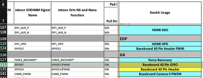

Now, let’s say we want to use PIN 32 from the header, which is GPIO07.
And the reason why I decided to go with GPIO07 is because on the pinmux it is described as Baseboard 40 Pin GPIO on Devkit Usage. Which means that is probably not being used by anything else, which makes it easier to configure.
If we further check the pinmux configuration, it says that by default this pin is configured as input with an initial state of Internal PullDown.
So we might need to change this, and there is a couple of ways of doing it:
  1. You can generate a custom pinmux for your board.
  2. You can dynamically configure your pinmux with devmem tool.
Since it is easier for testing, lets go with option 2.
