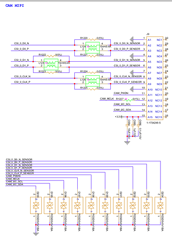

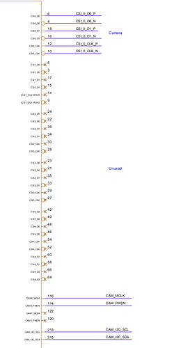

CSI0 in orni nano jetpack6.2 cannot read MIPI video stream of sc132gs normally
  1. Use CSI0 connection between orin nano and sc132gs.

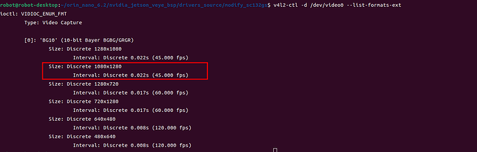

  1. After loading the driver, the system has the following log
[  487.654267] cssc132 9-0030: probing v4l2 sensor
[  487.654275] /home/robot/orin_nano_6.2/nvidia_jetson_veye_bsp/drivers_source/modify_sc132gs/cs_sc132.c cs_sc132_probe 878
[  487.654363] /home/robot/orin_nano_6.2/nvidia_jetson_veye_bsp/drivers_source/modify_sc132gs/cs_sc132.c cs_sc132_parse_dt 655
[  487.654367] /home/robot/orin_nano_6.2/nvidia_jetson_veye_bsp/drivers_source/modify_sc132gs/cs_sc132.c cs_sc132_power_get 588
[  487.654436] cssc132 9-0030: tegracam sensor driver:cssc132_v2.0.6
[  487.654442] /home/robot/orin_nano_6.2/nvidia_jetson_veye_bsp/drivers_source/modify_sc132gs/cs_sc132.c cs_sc132_power_on 506
[  487.654445] /home/robot/orin_nano_6.2/nvidia_jetson_veye_bsp/drivers_source/modify_sc132gs/cs_sc132.c cs_sc132_fuse_id_setup 784
[  487.654747] /home/robot/orin_nano_6.2/nvidia_jetson_veye_bsp/drivers_source/modify_sc132gs/cs_sc132.c cs_sc132_read_reg 155
[  487.654971] /home/robot/orin_nano_6.2/nvidia_jetson_veye_bsp/drivers_source/modify_sc132gs/cs_sc132.c cs_sc132_read_reg 155
[  487.654978] cssc132 9-0030: read sensor id 0132
[  487.654983] cssc132 9-0030:  camera id is cs-mipi-sc132
[  487.654986] /home/robot/orin_nano_6.2/nvidia_jetson_veye_bsp/drivers_source/modify_sc132gs/cs_sc132.c cs_sc132_board_setup 844
[  487.655035] /home/robot/orin_nano_6.2/nvidia_jetson_veye_bsp/drivers_source/modify_sc132gs/cs_sc132.c cs_sc132_power_off 557
[  487.655077] tegra-camrtc-capture-vi tegra-capture-vi: subdev cssc132 9-0030 bound
[  487.655611] video4linux video0: tegra_channel_s_ctrl: 10100856 set vi timeout disable 0
[  487.655916] cssc132 9-0030: Detected CS_MIPI_SC132 camera
[  487.661879] /home/robot/orin_nano_6.2/nvidia_jetson_veye_bsp/drivers_source/modify_sc132gs/cs_sc132.c cs_sc132_open 860

  1. The hardware connection has been verified by imx219, and the device tree has also been rewritten based on the successful verification of imx219.
  2. Jetson originally did not support mono 10, but has loaded the mono10 driver.

It is not DevKit. It is a self-developed board based on the previous nx Devkit. It is connected to CSI0 and CSIA.
hello venceplace,
you may double check the board schematic,
please see-also Topic 318537 for an example to debug discarding frame corr_err messages.

sc132gs 的分辨率为1080 * 1280(宽为1080,高为1280),但是gst-launch-1.0和v4l2都不支持这个分辨率的读写,请问有什么办法读出这个尺寸的摄像头数据吗?
我该如何配置才能使用如图中红色方框的分辨率读取摄像头中的数据。
hello venceplace,
may I know what did you meant it’s not supported with gst-launch-1.0 and v4l2?
please refer to developer guide for the Device Properties section.
here’s DT property, use_sensor_mode_id to select a specific sensor mode.
so,
you may using v4l pipeline with --set-ctrl sensor_mode=Xfor mode selection.
for instance,
$ v4l2-ctl -d /dev/video0 --set-fmt-video=width=1280,height=720,pixelformat=RG10 --set-ctrl bypass_mode=0 --set-ctrl sensor_mode=4 --stream-mmap --stream-count=100
设备树设置的分辨率为1080 * 1280,然后只有一个mode就是mode0,附带设备树文件。
tegra234-p3767-camera-p3768-cssc132-B.txt (5.6 KB)
sensor文件中提到的分辨率是这样说的
我理解是宽为1080,高为1280。然后我试过nvarguscamerasrc,nvv4l2camerasrc,v4l2src 等插件都无法正常读取BG10的视频流。
