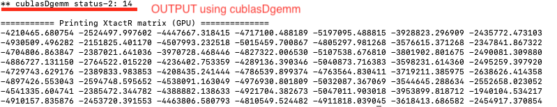

I am trying to do the following simple operations on some tall skinny matrices (# of rows >> # of cols):
blockVectorR = blockVectorX * lambda
blockVectorR = blockVectorX - blockVectorR
activeBlockVectorR = get the active columns of blockVectorR(see activeMask, column i is active if activeMask[i] = 1)
XtactR = blockVectorX’* activeBlockVectorR
[Dimension: blockVectorR, blockVectorX => Mblocksize, activeBlockVectorR => McurrentBlockSize, lambda => blocksizeblocksize, XtactR => blocksizecurrentBlockSize]
I am using both cublasDgemm routine and OpenMP target offloading for this purpose. But the weird thing is, the very last cublasDgemm call [which is doing transpose(X)*Y type operation] is giving me CUBLAS_STATUS_INTERNAL_ERROR. Though the the final output of the following codeblock matches with two other implementation of the same oprations [ one is using Intel MKL library & cpu kernels and the other one is using NVBLAS dgemm routine and same GPU kernels in following codeblock]. I have attached the outputs here.
Can anyone please point me what am I doing wrong? Or am I missing something here? I really appreciate your help.

        //blockVectorR = blockVectorX * lambda
        gemmStat = cublasDgemm(handle, CUBLAS_OP_N, CUBLAS_OP_N, blocksize, M, blocksize,
                  &cudaAlpha, d_lambda, blocksize, d_blockVectorX, blocksize, &cudaBeta, d_blockVectorR, blocksize);
        if(gemmStat != CUBLAS_STATUS_SUCCESS) {printf("** cublasDgemm status-1: %d\n", gemmStat);}
        //blockVectorR = blockVectorX - blockVectorR
        mat_sub_GPU_v2(d_blockVectorX, d_blockVectorR, d_blockVectorR, M, blocksize);
        //activeBlockVectorR = get the active columns of blockVectorR(first 7 columns are active, see activeMask array)
        getActiveBlockVector_GPU_v2(d_activeBlockVectorR, d_activeMask, d_blockVectorR, M, blocksize, currentBlockSize);
        //XtactR = blockVectorX'* activeBlockVectorR
        gemmStat = cublasDgemm(handle, CUBLAS_OP_N, CUBLAS_OP_T, currentBlockSize, blocksize, M,
                  &cudaAlpha, d_activeBlockVectorR, currentBlockSize, d_blockVectorX, blocksize, &cudaBeta, devPtrXtactR, currentBlockSize);
        if(gemmStat != CUBLAS_STATUS_SUCCESS) {printf("** cublasDgemm status-2: %d\n", gemmStat);}
        //copying result back to CPU
        cuberror = cudaMemcpy(XtactR, devPtrXtactR, blocksize * currentBlockSize * sizeof(double), cudaMemcpyDeviceToHost);
        if( cuberror != 0 ){ printf("cudaMemcpy Failed XtactR: %d\n", cuberror);}
        printf("\n=========== Printing XtactR matrix (GPU) ==============\n");
        print_matrix(XtactR, blocksize, currentBlockSize);
