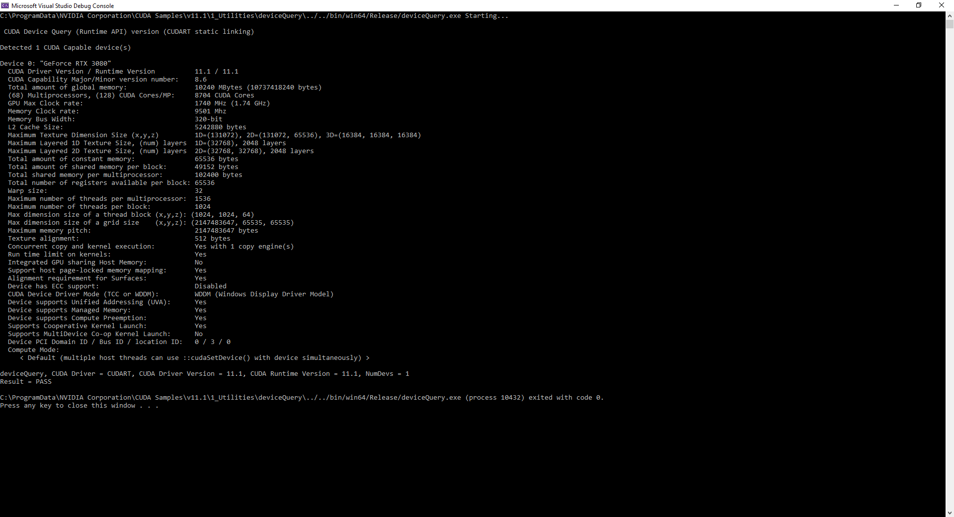

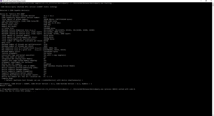

Can anybody tell me if there has been some change in ampere architecture? My 3080 reports only 1 copy engine while the 2080 SUPER ( which is supposed to be inferior compared to 3080 ), reports 3 copy engines.

I have zero experience with Ampere-based GPUs. I would suggest filing a bug report with NVIDIA.
Maybe (speculation!) NVIDIA has changed the definition of “copy engine” with Ampere and the new GPUs sport a new all-singing-all-dancing copy engine with multiple channels. If that were the case, reporting that as one engine would not be helpful to programmers who try to assess whether simultaneous bi-directional DMA transfers are possible.
I don’t happen to know the answer there, I suggest filing a bug report also.
Yes, I have filed a bug report for Windows 10.
The result is fine on Ubuntu 18.04 with CUDA 11.1, on which 2 async engines are reported, which is understandable since my variant ( MSI Ventus 3X OC ) does not have any NVLink or SLI connectors.
great, I hope you included all that info (that it appears to be correct on linux) in the bug report. Thanks for filing the bug, especially since it seems like it might be a driver issue.
