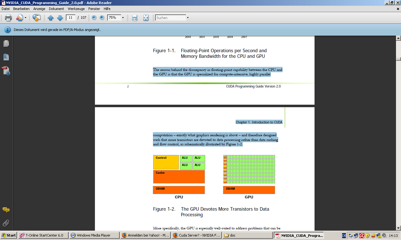

The gpu (read cuda) is meant to be for massive parallel (mathematical) computation. it is not/nor ment to work like a (general purpose) cpu.
I’m not an expert (yet), but I think Akg is right.
The GPU is meant to work up ‘simple’ instructions, i.e. permanently repeating calculations.
In contrast to the CPU the GPU has hardly (L1) cache, so if there come a lot of different instructions one by another,
there’s a high memory latency, what is not the case for the CPU (as the memory is cached).
You can expect that a webserver has to work on ‘chaotic’ code with many different instructions, so you
won’t get good performance by using a GPU.
Have a look at the screenshot…
