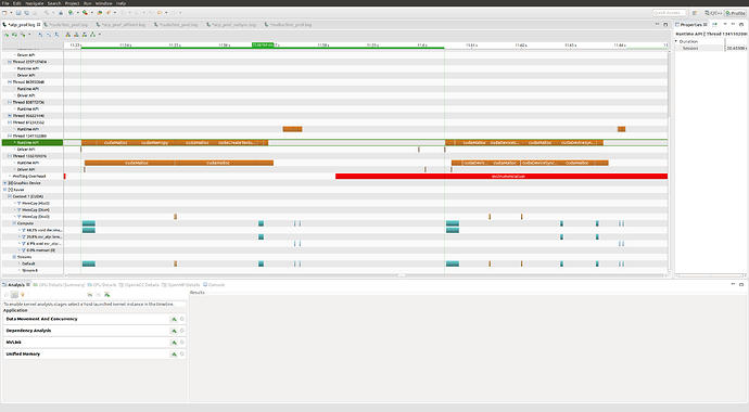

I attached a screenshot of the nvprof’s trace. One can clearly see that cudaMallocs take to long and block also things like cudaStreamSynchronize() (obviously as we only use one stream) and cudaCreateTextureObject. This results in a quite low usage of the iGPU.
So the question is, is this the expected behavior of the DriveAGX? Is there a faster way to allocate memory for the iGPU?

We can allocate memory on GPU only using cudaMalloc(). There is no faster way as such. We recommend creation of memory buffers once in the begining and re-use them in the application as creating them in the middle of application introduce undeterministic latency. CUDA malloc is a blocking call. Also, we do not focus on memory allocation API KPI as it is just one time allocation in an application typically. I do notice more allocation time using DRIVE SW 10.0.
Could you share you nvprof file to get more insights into the issue.
