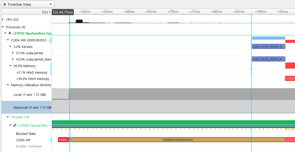

I guess the next question I have now, is why the new drivers seem to take so long to initiate the actual copy. See the following screenshot from Nsight System, where nothing happens for more than 40 milliseconds after initiating the copy (the actual copy takes about 65 microseconds).
Could it be that is the actual problem? That using previous drivers, the copy was so quick it wouldn’t have impacted performance measurements. But somehow the new drivers delay the copying by a noticeable amount of time, for some reason?
is this a consistent delay, or just occuring on the first cudaMemcpy() call?

The code above is run 10x in a loop. Behaviour is consistent.
I’ve tried replacing the memory allocations with cudaMallocHost. Interestingly it makes things worse. Nsight Compute for some reason then does not show when the actual copy occurs on the GPU nor does it then give the associated performance information. On top of that, the kernel launch has a latency of 40 milliseconds, but putting a cudaDeviceSynchronize after the memory copy does not solve that issue (whereas previously the 40ms latency was on the memory copy).
