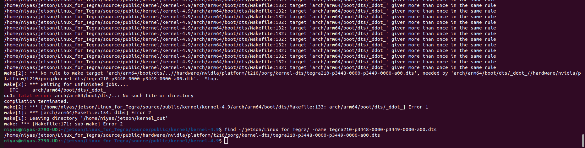

one error :
make[2]: *** No rule to make target ‘arch/arm64/boot/dts/..//hardware/nvidia/platform/t210/porg/kernel-dts/tegra210-p3448-0000-p3449-0000-a00.dts’, needed by ‘arch/arm64/boot/dts/ddot//hardware/nvidia/platform/t210/porg/kernel-dts/tegra210-p3448-0000-p3449-0000-a00.dtb’. Stop.
make[2]: *** Waiting for unfinished jobs…
DTC arch/arm64/boot/dts/ddot
cc1: fatal error: arch/arm64/boot/dts/..: No such file or directory
compilation terminated.
make[2]: *** [/home/inthings/jetson_4/Linux_for_Tegra/source/public/kernel/kernel-4.9/arch/arm64/boot/dts/Makefile:133: arch/arm64/boot/dts/ddot] Error 1
CC kernel/kallsyms.o
make[1]: *** [arch/arm64/Makefile:154: dtbs] Error 2
second error :
/home/inthings/jetson_4/Linux_for_Tegra/source/public/kernel/nvidia/drivers/net/wireless/realtek/rtl8812au/hal/rtl8812a/usb/rtl8812au_xmit.c: In function ‘upload_txpktbuf_8812au’:
/home/inthings/jetson_4/Linux_for_Tegra/source/public/kernel/nvidia/drivers/net/wireless/realtek/rtl8812au/hal/rtl8812a/usb/rtl8812au_xmit.c:433:61: error: bitwise comparison always evaluates to false [-Werror=tautological-compare]
433 | while ((rtw_read32(adapter, REG_PKTBUF_DBG_CTRL) & BIT23) == 1) {
CC drivers/platform/tegra/tegra_l1ss_kernel_interface.o
CC [M] drivers/net/wireless/realtek/rtlwifi/rtl8821ae/pwrseq.o
CC [M] drivers/net/wireless/realtek/rtl8814au/hal/rtl8814a/rtl8814a_rf6052.o
cc1: all warnings being treated as errors
make[1]: *** [/home/inthings/jetson_4/Linux_for_Tegra/source/public/kernel/kernel-4.9/Makefile:1122: drivers] Error 2
make[1]: Leaving directory ‘/home/inthings/jetson_4/kernel_out’
make: *** [Makefile:171: sub-make] Error 2
inthings@inthings-Z790-UD:~/jetson_4/Linux_for_Tegra/source/public/kernel/kernel-4.9$
Please directly share the commands you ran in your terminal for us to check.
inthings@inthings-Z790-UD:~/jetson_4/Linux_for_Tegra/source/public/kernel/kernel-4.9$ make ARCH=arm64 O=$TEGRA_KERNEL_OUT tegra_defconfig
make[1]: Entering directory ‘/home/inthings/jetson_4/kernel_out’
HOSTCC scripts/basic/fixdep
GEN ./Makefile
HOSTCC scripts/kconfig/conf.o
SHIPPED scripts/kconfig/zconf.tab.c
SHIPPED scripts/kconfig/zconf.lex.c
SHIPPED scripts/kconfig/zconf.hash.c
HOSTCC scripts/kconfig/zconf.tab.o
HOSTLD scripts/kconfig/conf
configuration written to .config
inthings@inthings-Z790-UD:~/jetson_4/Linux_for_Tegra/source/public/kernel/kernel-4.9$ make ARCH=arm64 O=$TEGRA_KERNEL_OUT -j8
make ARCH=arm64 O=$TEGRA_KERNEL_OUT -j8 → this command found the error
I mean every step. Not just one make command. Every command before this make happened.
Including all the variable that got exported.

Where are you building this driver code? Is it on your host PC?
yes Linux 20.04
But looks like you didn’t export toolchian for your cross compile here.
Hi WayneWWW
i did the export toolchain
but still have the issue
Please run the command and see if the toolchain is shown:
$ ls /usr/bin/aarch64-linux-gnu-*
To ensure the path is correct.
