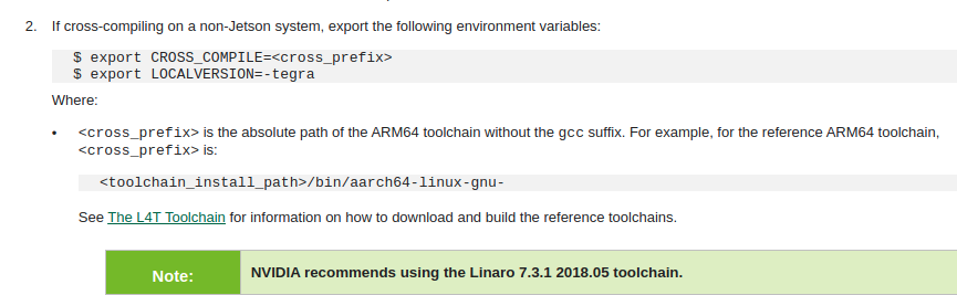

That was it!
I set the local version and appended a string to identify custom kernel…
when i removed that and made it simply “-tegra” it works great!!
One last issue is, it seems there might be a bug in the makefile?
I get this gcc error
```auto
gcc: error: unrecognized command line option ‘-mlittle-endian’; did you mean ‘-fconvert=little-endian’?

What is your exact command line? If you have some cross compile flags in it when not used, or vice versa, then this could do that. Basically mistaken architecture…which is what native versus cross compile is about.

I run these two make commands
```auto
make ARCH=arm64 O=$TEGRA_KERNEL_OUT tegra_defconfig
make ARCH=arm64 O=$TEGRA_KERNEL_OUT -j12
where `$TEGRA_KERNEL_OUT` is env var pointing to my output path.
and `tegra_defconfig` is the standard config file that shipped with Jetpack4.5, i did not modify it `Linux_for_Tegra/sources/kernel/kernel-4.9/arch/arm64/configs/tegra_defconfig`

This would fail regardless of cross compile or native compile. If native compile you need to leave out the “`ARCH=arm64`”. If cross compile, then you need to additionally specify the toolchain (the “`CROSS_COMPILE=/some/tool/chain/location/bin/...`”).

`CROSS_COMPILE` is already exported and points to my toolchain earlier in my build script.
`export CROSS_COMPILE="${1}/bin/aarch64-linux-gnu-"` where $1 is passed in as a param to my script of where toolchain is installed.

Then this should work.
However, if there is a mistake on big/little endian, then something is really wrong with the compile options or arguments. I don’t know what the script you use does, but it seems like there is some sort of incorrect big/little endian setup (which I would normally attribute to not having cross compile arguments correct).
FYI, people can set up arm64 for either big or little endian (in hardware) when designing their CPU, but the default (and the one NVIDIA uses) is little endian. That error tends to imply that either the build does not know which endian, or else it is using big endian and the hardware wants little endian. On the Jetson, see:
`lscpu`
On the kernel module itself, assuming name is “`module.ko`”, then what do you see from:
`readelf -h module.ko`

oh - and I got it from following this in the nvidia documentation:
`https://docs.nvidia.com/jetson/l4t/index.html#page/Tegra%20Linux%20Driver%20Package%20Development%20Guide/kernel_custom.html`
 ![Screenshot from 2021-03-07 17-05-03](https://global.discourse-cdn.com/nvidia/original/3X/4/7/471fab0671bccf3bf10db8bee0b76537113649a9.png)
This in turn points to toolchain download at:
[http://releases.linaro.org/components/toolchain/binaries/7.3-2018.05/aarch64-linux-gnu/gcc-linaro-7.3.1-2018.05-x86\_64\_aarch64-linux-gnu.tar.xz](http://releases.linaro.org/components/toolchain/binaries/7.3-2018.05/aarch64-linux-gnu/gcc-linaro-7.3.1-2018.05-x86_64_aarch64-linux-gnu.tar.xz)
