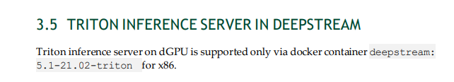

Sorry for the late, for using local deepstream sdk, you are still using nvinferserver as the infer pluin, rihgt?
So that’s must be the problem since we only support Triton server via docker on x86, you can see the release note https://docs.nvidia.com/metropolis/deepstream/DeepStream_5.1_Release_Notes.pdf

Please see the following info in release note I shared, currently we only support Triton server via docker on x86 officially, so please don’t use nvinferserver as a infer pluin without docker.
