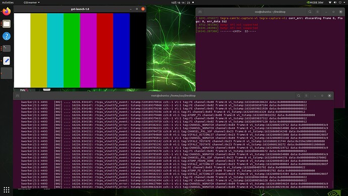

2.Using GStreamer to Open the Device Without Connecting the AHD Camera (Outputting Test Video)
gst-launch-1.0 -v v4l2src device="/dev/video4" ! video/x-raw,framerate=30/1,width=1920,height=1080,format=UYVY ! xvimagesink &
We can see that it outputs the color test image normally. However, we also noticed an error: CHANSEL_NOMATCH.

3.Using GStreamer to Open the Device with AHD Camera Connected
Initially, we can receive data from the AHD camera. However, after a few seconds to over a minute, the image shows corruption, and we can observe corresponding errors in dmesg and trace_pipe.
Live dmesg output:
[16771.638938] --------cntt=  24-----
[16778.425426] tegra-camrtc-capture-vi tegra-capture-vi: corr_err: discarding frame 0, flags: 0, err_data 512
[16778.465432] tegra-camrtc-capture-vi tegra-capture-vi: corr_err: discarding frame 0, flags: 0, err_data 512
[16778.505429] tegra-camrtc-capture-vi tegra-capture-vi: corr_err: discarding frame 0, flags: 0, err_data 512
[16778.542079] tegra-camrtc-capture-vi tegra-capture-vi: corr_err: discarding frame 0, flags: 0, err_data 512
We can see that after seven seconds of capturing, there is a screen distortion phenomenon, and image capture cannot continue.

In the trace_pipe log, we saw the following errors:
rtcpu_nvcsi_intr : class:CORRECTABLE_ERR : status : 0x00000004
rtcpu_vinotify_error : tag : CHANSEL_NOMATCH
rtcpu_vinotify_error:  tag : CSIMUX_FRAME
tcpu_nvcsi_intr : class:GLOBAL type:STREAM_VC : status:0x00000008
Therefore, we would like to ask what could be the cause of these errors. Is it due to incorrect device tree properties, incomplete MIPI signals, or perhaps we should consider making a new camera board? We look forward to your reply.
The log tell the payload data CRC error that could be signal problem.
Thank you for your reply. We have found that there may be some issues with the camera baseboard. We will remake a board and check the situation.
