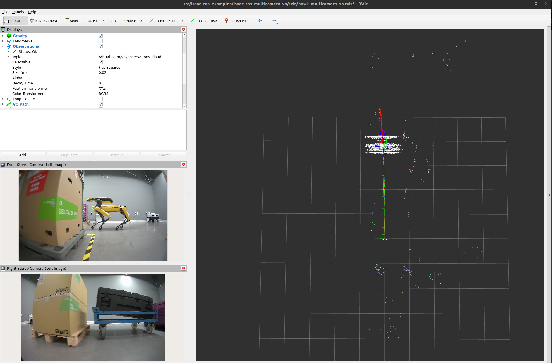

This functionality can only be used within a ROS node if the enable_observations_export flag is set to True in the cuvslam.h file, which is part of the initial cuvslam configuration. To enable this configuration and obtain the point cloud of observations through the ROS node, modify the parameters in the launch file for the isaac_ros_visual_slam node as follows:
  • Enable visualization by setting: 'enable_slam_visualization': True
  • Enable observation visualization specifically by setting: 'enable_observations_view': True
  • These settings will work whether SLAM is enabled or not: 'enable_localization_n_mapping'
Once configured, the observations will be published via the following topic: visual_slam/vis/observations_cloud
