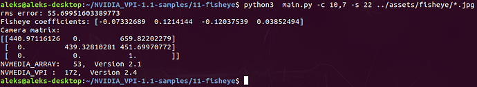

Could you try if you can run our fisheye sample first?
It calls the vpi.WarpMap as well and it should work on JetPack 4.6.
/opt/nvidia/vpi1/samples/11-fisheye/
Hi Aasta, thanks! Do I just run this from the command line? In VS Code, I’m getting “too few arguments”. Seems like I need some checkerboard images too?
EDIT:
So that seemed to work.
Could you also try it with VS?
In the sample, it calls vpiWarpMap as well.
This is probably a stupid question but I’m getting “too few arguments” when running in VS Code. How do I test this with the needed arguments like I did with the above example from the terminal?
There is also a terminal within VS code, and you may have noticed that when you hit the run button it just pastes the command to run the file into this terminal. so you could just copy and paste (ctrl + shift + c/v) that command with your arguments added to it.
(make sure the vscode terminal is in the right directory also).
There are also other ways like a launch.json file, but i think the terminal is the easiest way.
that seemed to work. But isn’t that just like running it in a linux terminal? I mean, would this properly test if it works in VS Code?
command:
python3 main.py -c 10,7 -s 22 …/assets/fisheye/*.jpg
EDIT
Anyway, problem seems fixed as this code seem to run fine.
