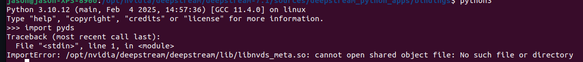

Hi, I have installed Deepstream 7.1 and is working fine for the C++ version. Right now i am installing the python bindings and i have issue on import pyds
Please advise
Hi, i resolved the issue by copying the library from deepstream-7.1 to deepstream. Can you provide me the symbiolic link command so that i can use link instead of copying the lib folder

But it is installed under
/opt/nvidia/deepstream/deepstream-7.1
This is expected behavior, /opt/nvidia/deepstream/deepstream just a soft symbol link for deepstream-xx. Try this command.
sudo  ln -s /opt/nvidia/deepstream/deepstream-7.1/ /opt/nvidia/deepstream/deepstream
