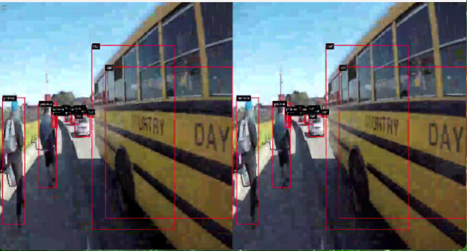

Deepstream 9.0 nvdsosd cpu mode show black border when using multiple stream
• Hardware Platform (Jetson / GPU) 3090RTX
• DeepStream Version 9.0
• TensorRT Version deepsteram 9.0 isntallation guide
• NVIDIA GPU Driver Version (valid for GPU only) 590
i try to use multiple stream in deepstream 9.0 (using deepstream python binding_ but when i change nvdsosd to cpu-mode i get a black border in video
Screenshot from 2026-06-29 11-35-43
Which sample are you testing? what is the complete media pipeline? The issue can’t be reproduced by the following gst-launch command-line. could you prvoide a simplifed gst-launch pipeline or simplifed code to reproduced the issue? Thanks!
gst-launch-1.0 filesrc location=/opt/nvidia/deepstream/deepstream/samples/streams/sample_720p.mp4 ! qtdemux  ! h264parse ! nvv4l2decoder ! mux.sink_0 nvstreammux name=mux batch-size=1 width=1920 height=1080 ! nvinfer config-file-path=dstest1_pgie_config.yml ! nvmultistreamtiler  ! nvvideoconvert ! 'video/x-raw(memory:NVMM),format=RGBA' ! nvdsosd process-mode=0 !  nvvideoconvert ! 'video/x-raw(memory:NVMM),format=I420' ! nvv4l2h264enc bitrate=1000000 ! filesink location=test_cpu.264  filesrc location=/opt/nvidia/deepstream/deepstream/samples/streams/sample_720p.mp4 ! qtdemux ! h264parse ! nvv4l2decoder !  mux.sink_1
There is no update from you for a period, assuming this is not an issue anymore. Hence we are closing this topic. If need further support, please open a new one. Thanks.
i foind out that when i use cnvmultistreamtiler this happends to me
Thanks for the update! could you provide the reproducing steps? Thanks!
As shown in the screenshot , the issue can’t be reproduced using the following cmd, which uses nvdsosd(cpu mode) and nvmultistreamtiler.
i fix this issue by changing nvbuf of all element to unified.
my pipeline was like this
8 nvurisrcbin → nvstreammxu → nvinfer → nvmultistreamtiler → nvdsosd → egeglesink
To reproduce this issue, which python sample are testing or referring to? you mean the issue will be fixed after adding the following codes for all nv plugins? the issue will remain without the following codes? Or could you provide a simplifed codes? Thank you!
        mem_type = int(pyds.NVBUF_MEM_CUDA_UNIFIED)
        plugin.set_property("nvbuf-memory-type", mem_type)
the issue is fixed when I add an nvvideoconvert to convert the buffer to RGBA before nvstreamtiler.
I should also mention that this issue only occurs when nvdsosd is running in CPU mode with multiple camera.

regarding “because the png is too high”, you can compress zip file, then upload. to reproduce the issue, is you code based on deepstream_python_apps? then build and install wheels for DS9.0?
Currently, this issue still can’t be reproduced on dgpu with DS9.0 and the this simplified code ds_cpu_osd_jpeg.zip (3.2 KB), which uses nvdsosd CPU mode and has the similar pipline. could you provide a simplified test code? Thank you!
i can’t send you my code, you can have my whole pipeline in a dot file.
yes i’m using deepstream python bnidning
i uplad my piepline here:
t.zip (6.0 KB)
is there any help?
Thanks for sharing! After testing with t.zip, I still cannot reproduce the issue on my side.
You do not need to share your full source code. Please provide a simplified reproducer instead. for example, you can use sample_720p.mp4 instead rtsp sources.
You can use forum private email. please click forum avatar → "personal messages’ → “view all personal messages” → “new message”.
it’s not happening because i add capsfiler before nvmultistreamtiler, please remove capsfilter and try again
the problem happends when i use cpu-mode in nvdsosd without that capsfilter
Based on your pipeline t.dot and the above comment, we wrote a test code, but failed to reproducing the issue on dGPU+DS9.0. please refer to test.zip (1.2 MB), which including test codes, output picture. could you modify the test code or provide simplified code to reproduce the issue? Thank you!
i siad it happends when using more than 4 camera as inputs
I tested 9 sources in my last comment. test.zip includes the test codes, output picture. to narrow down this issue, 1. please test with other sources to check if it is related to the sources, for exmaple, you can push sample_720p.mp4 to a virtual rtsp server . 2. please help to reproduce the issue, as said in my last comment. 3. If you can’t share any codes, since nvdsosd is opensource, you can debug the nvdsosd codes. /opt/nvidia/deepstream/deepstream/sources/gst-plugins/gst-nvdsosd/, /opt/nvidia/deepstream/deepstream/sources/libs/nvll_osd/
