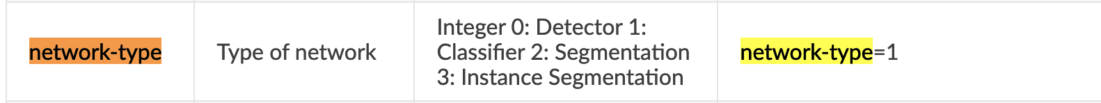

Why is the network-type set to 100 in the config?
According to the DeepStream 5.0.1 Plugin Manual, there is no value for network-type that says 100.
https://docs.nvidia.com/metropolis/deepstream/5.0.1/dev-guide/text/DS_plugin_gst-nvinfer.html
Besides, according to this, I think network-type needs to be 0 or 2 to use TensorMeta.
In addition, output-tensor-meta is not set in config. Isn’t that 1?
network-type=100 indicates others.
For more details, please check the API document below:
https://docs.nvidia.com/metropolis/deepstream/sdk-api/Api/Infer/Infer.html?highlight=nvdsinfernetworktype_segmentation#_CPPv420NvDsInferNetworkType
