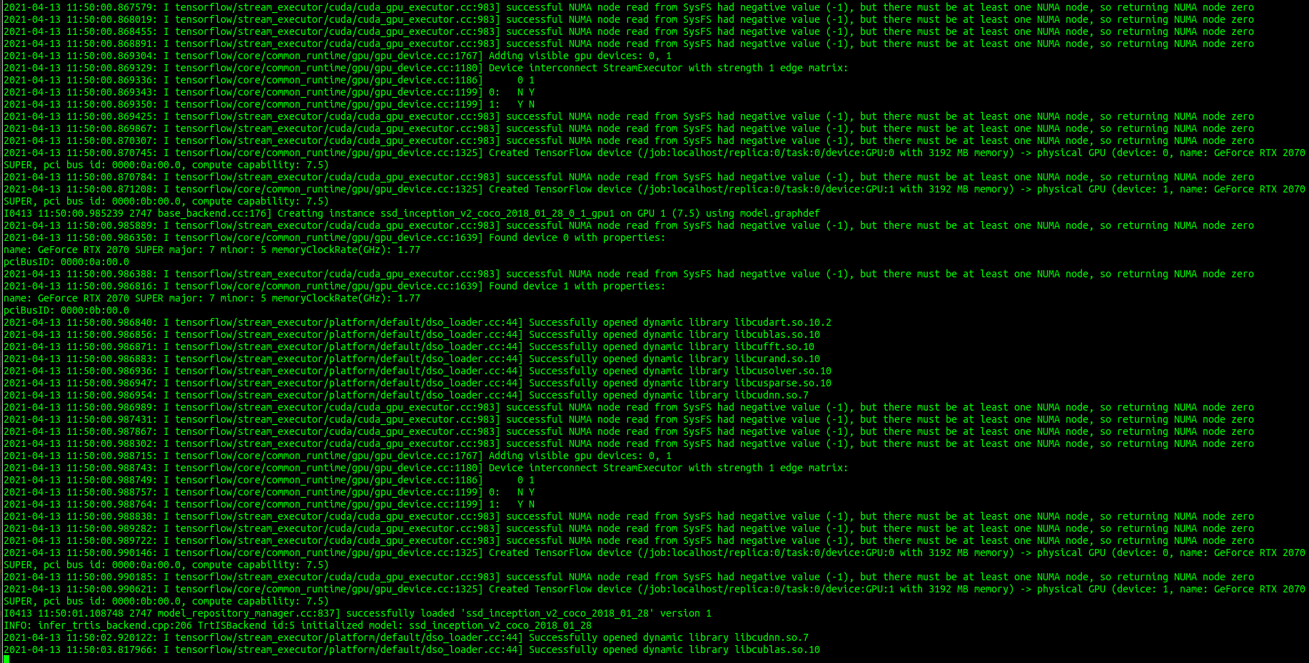

@amycao Thanks for your response, but as updating the driver effects other applications and may cause conflicts, do you have any suggestion for the freezing problem in v1.0 tag of deepstream_python_apps? I have attached running messages
It did not have error, how about run with CUDA_VISIBLE_DEVICES=0 preceding app you run.
No, This doesn’t have error but it freezes in this situation and doesn’t do anything. GPU resources are taken and nothing happens.
Can you run other samples?
