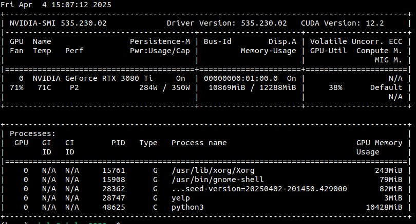

In Jetson Nano, I’m doing the deepstream testing & here is the spec:
I’m converting the model from other server.
The details about the server are here given below:
The python version that i’m converting the .pt model to ONNX Model is given below with parameters.
