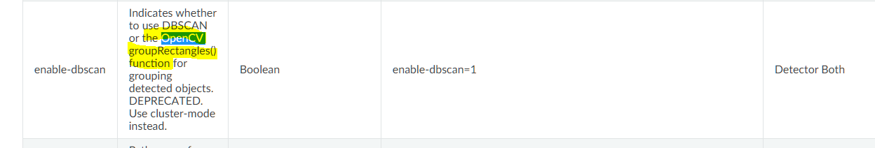

I have been reviewing deepstream code, and trying to understand the dependencies on OpenCV. Unfortunately, my company will not allow us to use OpenCV, and I am trying to figure out if using deepstream for RetinaNet Object Detection will still be possible.
Can I run a RetinaNet model using deepstream with OpenCV uninstalled, removed from .h .cpp files, etc?
If you can, what functionality is lost? All i see are a couple examples that use opencv, but it doesn’t appear to be needed to acquire video, inference, display video and bounding boxes.
if you don’t use “the OpenCV groupRectangles() function for grouping detected objects” function of nvdsinfer, RetinaNet model can run with deepstream without opencv.
But, opencv is using now in gst-nvinfer plugin, so you need to modofiy the nvdsinfer code (/opt/nvidia/deepstream/deepstream/sources/libs/nvdsinfer, /opt/nvidia/deepstream/deepstream/sources/gst-plugins/gst-nvinfer) to remove the opencv.
https://docs.nvidia.com/metropolis/deepstream/dev-guide/text/DS_plugin_gst-nvinfer.html
