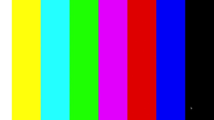

The HDMI capture card is an integrated PCIE card. When unplugging the HDMI cable, the deepstream app shows the following screen (but does not exit):
