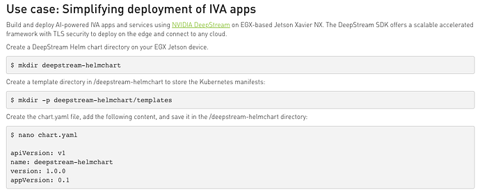

All things good up until running command:
helm install --name-template deepstream deepstream-helmchart/
error:
Error: failed to download “deepstream-helmchart/” (hint: running helm repo update may help)
~/deepstream-helmchart/templates$ helm repo update
Hang tight while we grab the latest from your chart repositories…
…Successfully got an update from the “stable” chart repository
Update Complete. ⎈ Happy Helming!⎈
error persisted.
Missing an import step for newbie:
helm create deepstream-helmchart
Tac,
You don’t need to run helm create as we provided instructions how to create a helm directory and how to add the files to helm directory.
Thanks,
Anurag G

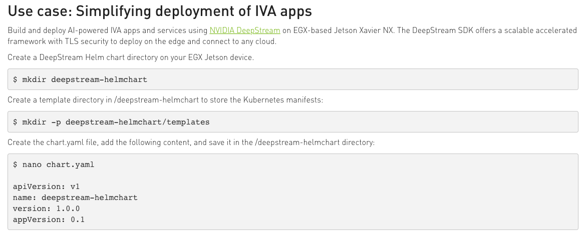

I ran into a small issue following the doc. The doc has you name the Chart file chart.yaml. For me on a cluster of Jetson Nanos, I got the following error. I then renamed the file to Chart.yaml (capital C is key) and the deployment worked as planned.
kejones@jetson-nano-1:~$ helm install --name-template deepstream deepstream-helmchart/
Error: validation: chart.metadata is required
kejones@jetson-nano-1:~$ mv deepstream-helmchart/chart.yaml deepstream-helmchart/Chart.yaml

Thank you for the feedback, updated the doc with Chart.yaml. it should be good now.
