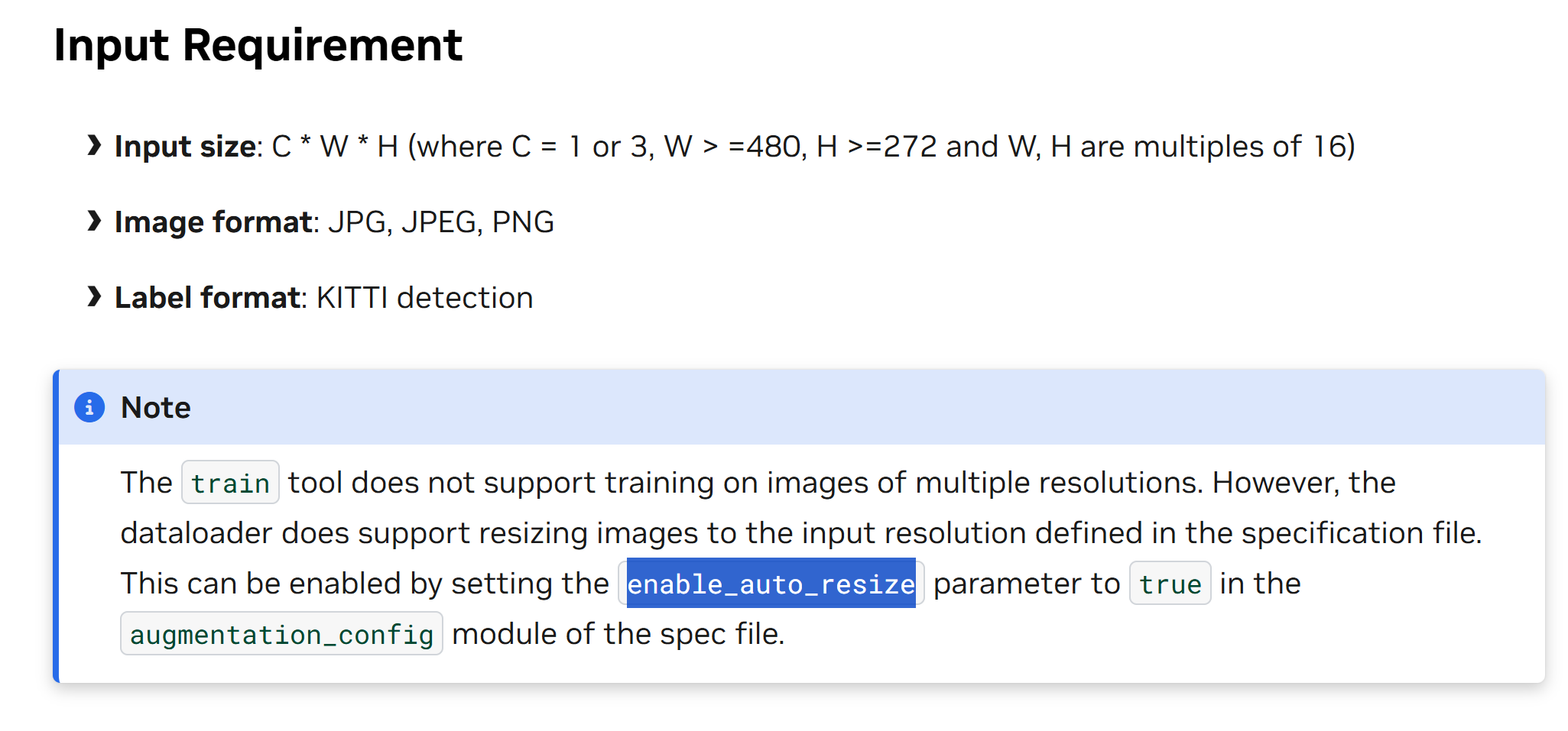

Please add enable_auto _resize: true to preprocessing.
  preprocessing {
    output_image_width: 832
    output_image_height: 256
    min_bbox_width: 1.0
    min_bbox_height: 1.0
    output_image_channel: 3
(from DetectNet_v2 — Tao Toolkit)
More, set to lower minimum_bounding_box_height: 4
minimum_height: 4
minimum_width: 4
More experiment, you can run with the 4.0 tao docker. Please docker pull nvcr.io/nvidia/tao/tao-toolkit:4.0.1-tf1.15.5 .

How about the training images average resolution, and are the objects small? Several images and their labels are helpful to understand.
No, for TAO 4.0.x, please use the .tlt version pretrained model from ngc.
Yes, it is needed to run exporting. You can run exporting inside the 4.0.x docker.
