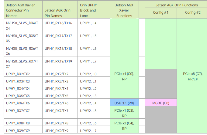

Please check with this document and list out all the things that do no exist on your carrier board.
Orin module is not actually compatible with Xavier carrier board. Lots of interface need to be changed or disabled.

Let me confirm this again first. Did you read the migration document I posted or not?
The Orin AGX only has fixed pattern which won’t directly work on Xaiver board.
For example, your change in ODMDATA only disabled the MGBE but the alternative is just a PCIe x8. This won’t happen to your Xavier AGX.

Let me help add some clarity. Our Gen 1 custom Carrier supports the Xavier AGX with Jetpack 5.1.2 and is only using the Gigabit Ethernet, USB 3.0, a PCIe x1 lane to support a M.2 NVMe SSD interface and a PCIe x4 endpoint.
Our Gen 2 custom Carrier has been updated to support the Orin AGX with Jetpack 5.1.2 with the identical interfaces listed above. We identified the pinout changes for the Orin AGX and incorporated them into the Gen 2 design.
So, when smcentee is saying it’s the same carrier board, what he means is that we are using the same interfaces between Gen 1 and Gen2. But, the hardware design was updated for Gen 2 to pick up the appropriate Orin AGX pins.
