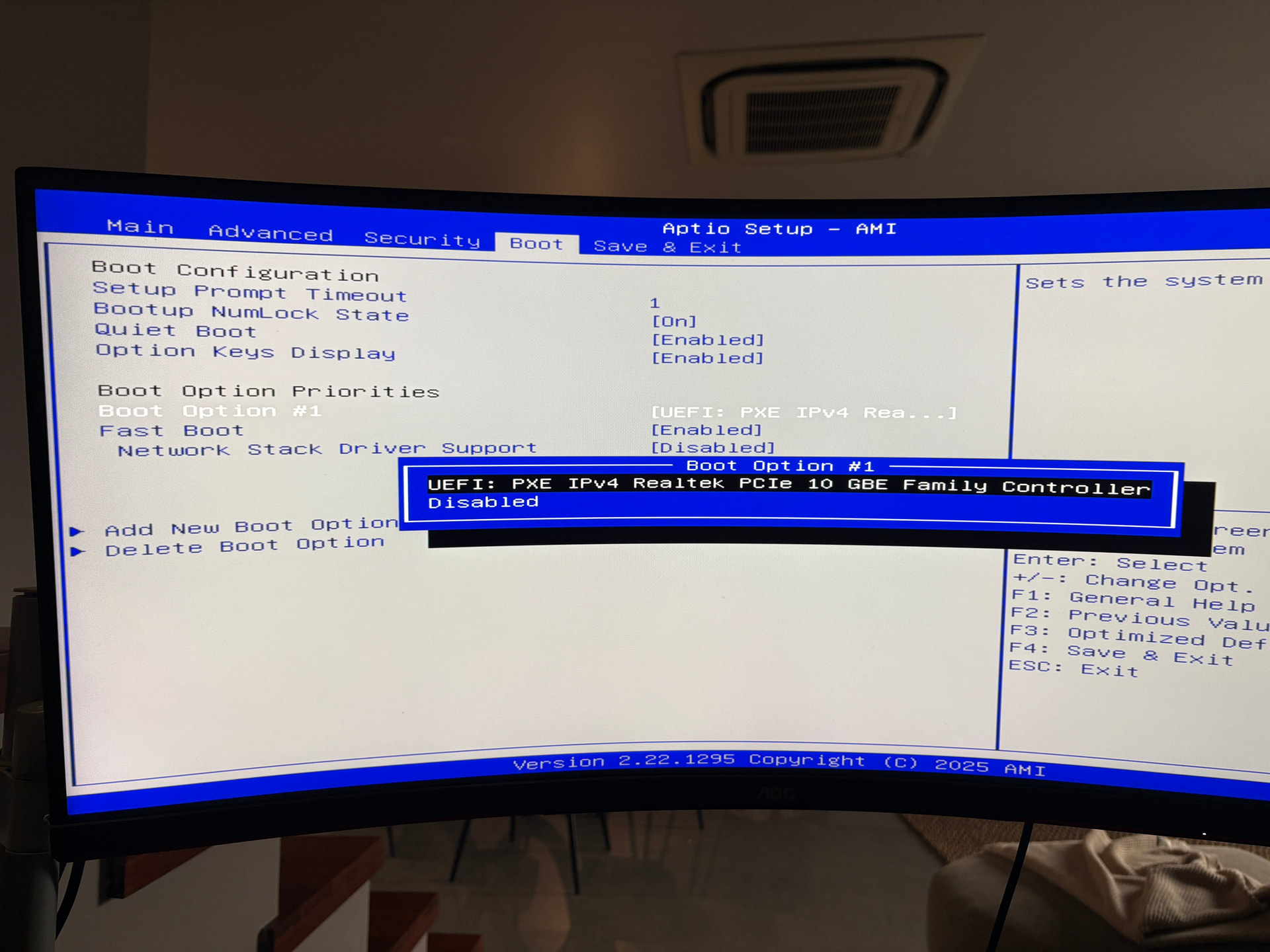

Hello! After first boot where I installed a local user account. I did this from a Mac mini over Wi-Fi the next day. I connected the device to the local network via an internet cable and couldn’t connect. After that, I connected the DGX to a keyboard and monitor, and then I saw this screen and then the BIOS screen. I can’t do anything else.

Are you still able to access the BIOS? If so, can you please navigate to the “Security” tab, then to NVMe configuration, and tell me what it says? After that, can you go to the “Boot” tab and tell what each of the Boot Options in “Boot Option Priorities” say?

This one in boot
and in NVMe now
Also before i try recovery system by USB but get this:
Based on this information, this is a candidate for an RMA. Please open a support ticket in: Spark Support
