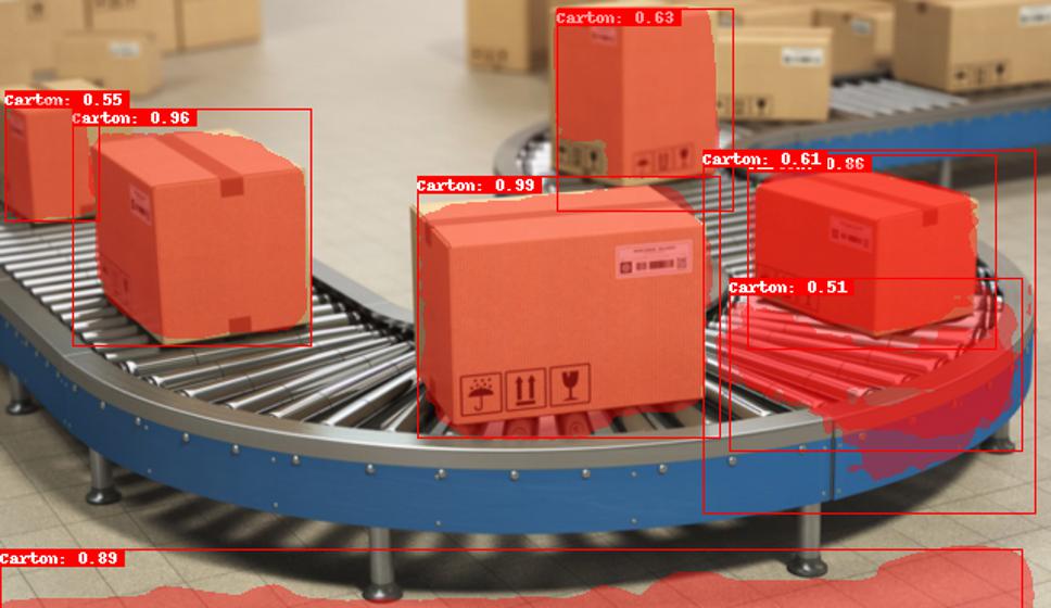

Dear @Morganh
I am trying to test Mask-Rcnn model with some images. I have observed, when I am testing the engine using tao deploy mask_rcnn inference I got correct output but when I am testing via script I am getting different.
With below command inside notebook giving correct output
command:
# Running inference for detection on a dir of images
!tao deploy mask_rcnn inference -i $DATA_DOWNLOAD_DIR/raw-data/test \
                                -r $USER_EXPERIMENT_DIR/maskrcnn_annotated_images \
                                -e $SPECS_DIR/maskrcnn_train_resnet50.txt \
                                -m $USER_EXPERIMENT_DIR/experiment_dir_unpruned/model.epoch-9.uff.engine \
                                -c $SPECS_DIR/coco_labels.txt \
                                -t 0.5
OutputImage
But when I am testing the same image with script but getting different output.

I have refer code from
Output:
Can u please suggest where are gaps?
Could you narrow down by leveraging the tao_deploy code again?
You can try this way.
  1. Inside the tao_deploy docker, git clone the code, and make sure the mask_rcnn inference can work.
  2. Then find the actual python code of mask_rcnn inference (Should be under /usr/…).
  3. Generate the standalone code which can work.
  4. Delete the code you are not interested in.
