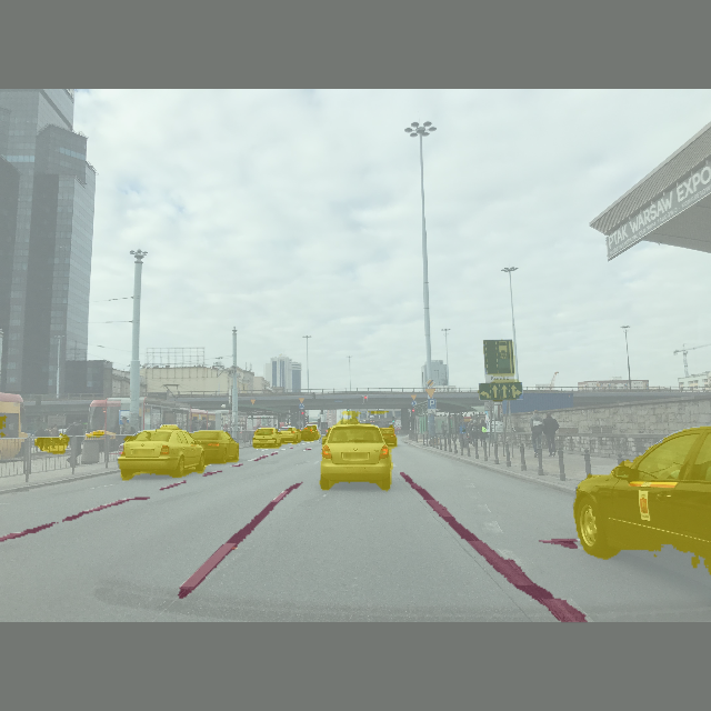

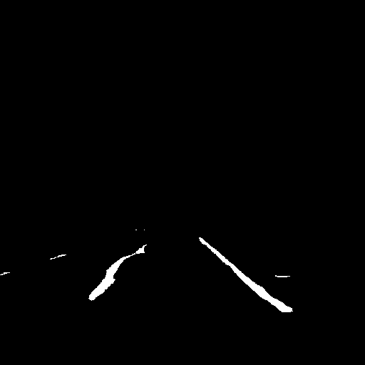

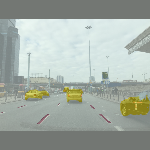

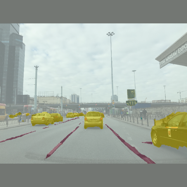

Hello, I am experiencing trouble reproducing results that I see when running tlt-infer on a trained unet model and the same model but exported and converted to a trt engine. The segmentation result with tlt-infer is much more accurate, whereas trt engine produces more errors and masks seem to be off the objects. I have checked many times that I do the preprocessing as required, run on same image etc. The issue persists with both a fp16 and fp32 engine. I attach the result from trt-infer and a mask for lane marking class produced by trt engine, to illustrate the kind of difference. Please let me know if you need extra input from me like models or specs

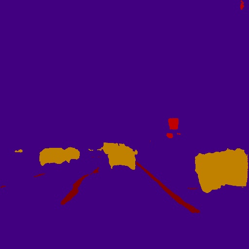

How about the “mask for lane marking class produced by trt engine”? Is it the result of running inference with deepstream?
no, this is a result of a custom script where I use python api of tensorrt to run the engine, and save binary masks of each class in the picture separately

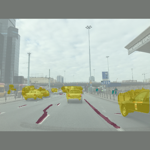

this is the result, seems to be an issue with the converter?
Thanks for the info. I will check further.
Could you please share the command line of generating trt engine inside tlt docker?
tlt unet run tlt-converter -k nvidia_tlt -t fp32 -e unet.engine -p input_1,1x3x512x512,1x3x512x512,10x3x512x512 pruned.etlt

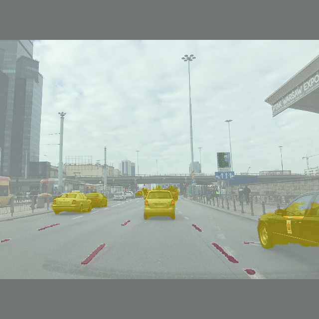

Thanks. Could you please try below experiment?
Please generate trt engine based on the unpruned etlt model. And run inference again.
engine:
tlt-infer:

I ran the test you suggested and I also get absolutely identical results for tlt and trt inferences.

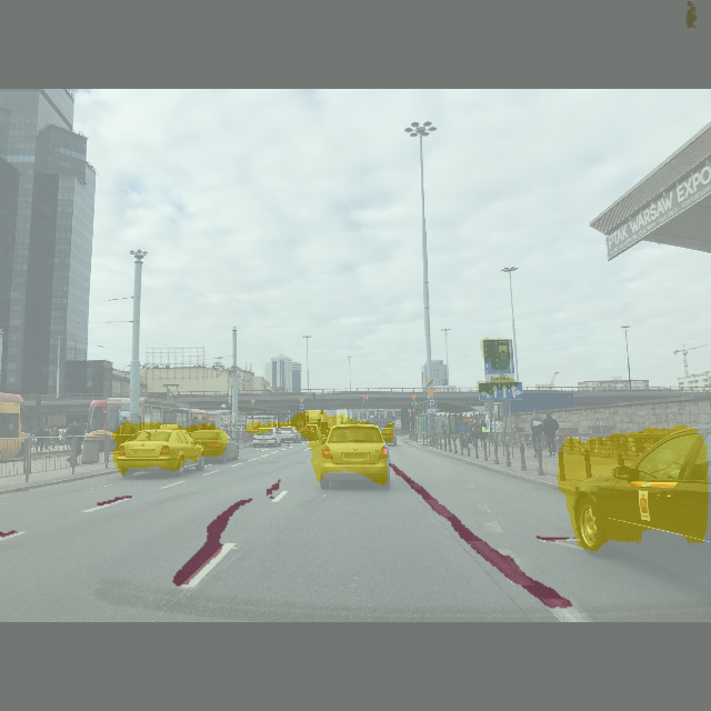

Then I retried training the model to be 100% sure I did not miss smth in configs. I stopped the training midway, ran inference and got this
Then exported to etlt, then converted to trt, using the same commands as mentioned above. Then ran inference on trt engine. got this
As you see, the trt result is much closer to tlt, but still noticebly off. Seems like the objects’ masks are somehow skewed to the left, especially on the left lane marking. Probably with more training the difference grows larger, because on my first examples you can see the same effect but to a greater extent.
