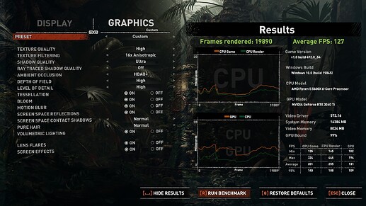

Shadow of the Tomb Raider (no Ray Traced Shadows, currently crashing in Linux). Loses 15% performance.
Windows:
Linux:
