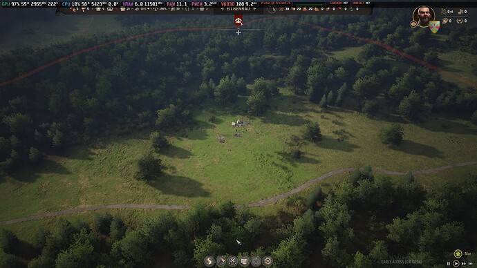

more examples of degration of performance using vulkan beta drivers 570.123.06
Game: Manor Lords
I also noticed that with a 5080, Baldur’s Gate 3 runs on 4K ultra at 150 fps in dx11, but only 58 in Vulkan mode? I read that BG3 Vulkan implementation is not great, and that it could simply be dx12 based, therefore requiring the same kind of translation calls than vkd3d. Is this issue related to the dx12 performance issue?
EDIT: it seems that the Vulkan implementation in BG3 is indeed very bad, so not really a good benchmark for perf. IJ Great Circle and RDR2 have indeed fantastic Vulkan performance.
Which game is that?
Forgot to add title name, the game is Manor lords
Thanks. I tried to test dx12 vs Vulkan with Red Dead Redemption 2, but only Vulkan works (and works well). DX12 crashes at launch. It is good to have several game candidates that can use both APIs to compare. So far, there is The Finals and Manor Lords then. I saw also that Strange Brigade was the first game to support both dx12 and Vulkan, i should check that out.
I just tested Strange Brigade, 4K Ultra with my 5080 using latest 570.133 drivers, Proton experimental and gamemoderun + mangohud. Interestingly, using their benchmark, DX12/VKD3D has better performance than Vulkan: 213 fps and 176fps, respectively. Not that this has any impact on playability in both cases - the engine for Strange Brigade being very ancient. But this shows that the DX12 performance loss is seen in more recent engines, possibly exacerbated with RT (but not only) and possibly by some bug in the handling of more recent dx12/Vulkan features that have appeared after Strange Brigade.
