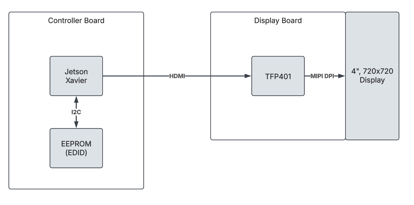

Hello, we are currently using the Jetson Xavier NX module on a custom carrier board which displays images on a small 4" 720x720 LCD screen. The HDMI signal is converted to MIPI DPI (parallel) standard using the Texas Instruments TFP401 IC. The custom carrier board also contains an EEPROM to provide a proper EDID for information to drive the display correctly. The following block diagram provides a simplified version of the hardware:

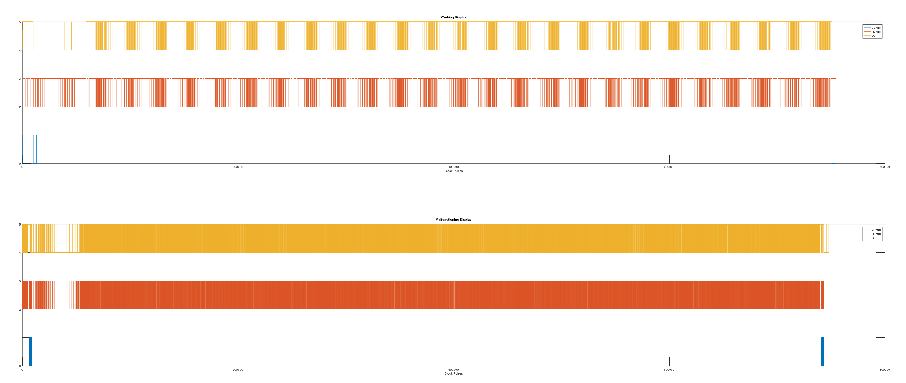

On JP5.1.1 and earlier, the display works perfectly fine, without error. However, in JP5.1.4, the HDMI output can be seen working correctly before booting into 35.6.0, and then the display communication breaks down after.
More testing has determined the following:
1. Changing the EDID by rewriting the file at `/sys/kernel/debug/tegradc.0/edid` had no effect on the lines
2. Using an improperly formatted EDID file (read from the EEPROM) caused the module to use a fallback EDID, which worked correctly.
3. After loading the fallback EDID, rewriting the EDID at `/sys/kernel/debug/tegradc.0/edid` allowed for the display to function normally.
4. Using the fallback EDID file (read from the EEPROM) had no effect on the lines.
Scope captures of the proper signals and improper signals were taken to determine whether a hardware issue exists. The scoped lines are the MIPI DPI bus control lines output from the TFP401 IC:
- DE, in Yellow
- HSNYC, in Red
- VSYNC, in Blue
The scope signals cover what should be a single image transfer to the display. As you can see, in the “good” scope captures, VSYNC has a clearly defined pulse high that signifies the start and end of the entire frame. in the “Bad” scope captures, the VSYNC line remains low, with the exception of a series of short pulses that are not long enough to provide the data needed for a full frame.

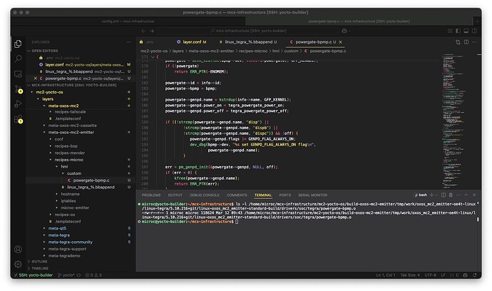

please apply these patches to your system and try again.
> **[Jetson Xavier platform specific configurations — NVIDIA Jetson Linux...](https://docs.nvidia.com/jetson/archives/r35.6.0/DeveloperGuide/SD/Kernel/DisplayConfigurationAndBringUp/XavierDisplayconfig.html?highlight=seamless#bypassing-the-seamless-display-issue)**

Hi Wayne,
We made these changes, and the display still comes up non-functioning.

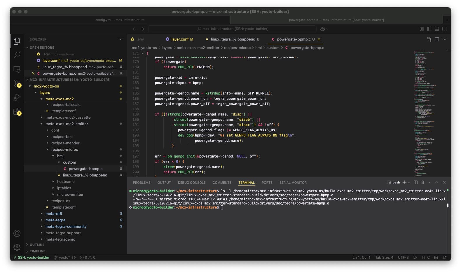

<div class="post-metadata">
**Author:** ![WayneWWW](https://sea2.discourse-cdn.com/nvidia/user_avatar/forums.developer.nvidia.com/waynewww/32/14043_2.png) [@WayneWWW](https://forums.developer.nvidia.com/u/WayneWWW)\
**Post date:** [March 13, 2025, 5:41am UTC](https://forums.developer.nvidia.com/t/display-output-issues-when-migrating-to-jetpack-5-1-4-on-jetson-xavier/326391/11 "2025-03-13T05:41:17Z")
</div>
> [@mzilvetti](#):
> ```auto
> [0.000000] Linux version 5.10.216-l4t-35.6.0+g4bce4d148ef3 (oe-user@oe-host) (aarch64-oe4t-linux-gcc (GCC) 13.3.0, GNU ld (GNU Binutils) 2.42.0.20240723) #1 SMP PREEMPT Sat Sep 7 11:18:48 UTC 2024
What change did you make there?
If you built out a kernel, then it should be at least in 2025. But the built time indicate your kernel didn’t go though any rebuild.
**Author:** ![rishabnayak](https://developer.download.nvidia.com/images/forums/profile-default-devtalk-84.png) [@rishabnayak](https://forums.developer.nvidia.com/u/rishabnayak)\
**Post date:** [March 13, 2025, 3:53pm UTC](https://forums.developer.nvidia.com/t/display-output-issues-when-migrating-to-jetpack-5-1-4-on-jetson-xavier/326391/12 "2025-03-13T15:53:35Z")
</div>
Hey Wayne,
We cache kernel builds. The changes to powergate-bpmp.c triggered a rebuild of the specific object as you see in the screenshot. We also confirmed that the disable-seamless flag was set in the devicetree by hexdumping the value in a running system.
We don’t update the build timestamp every build as that would force kernel rebuilds on every small os rebuild.
Do you have any other suggestions to fix the display bringup issue?

I am just talking about change that dev\_dbg to dev\_info in the screenshot you added which is just added by that patch.
 ![image](https://global.discourse-cdn.com/nvidia/original/4X/3/0/4/30413fa7ebaf30c557fab7b33047e0e3f3c3afde.jpeg)
If this is 100% reproduce issue every time, I think it is a problem that is still different from what that patch can enhance or fix.
One weird thing is the issue I am talking about here is present in every Jetpack5 version. Not only jp5.1.4 but also jp5.0.2/5.1/5.1.1.
Your comment that this issue is not there in jp5.1.1 does not make sense to me.
If you are pretty sure jp5.1.1 (rel-35.3.1) won’t hit. Please also check the status of jp5.1.2 and 5.1.3. This may provide some clues.
